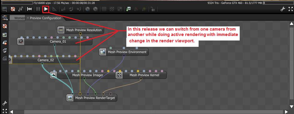

I think you could do that before in beta 2.46b. But what is even better: You can now create different RenderTargetNodes and set them up differently, for example different kernels, imager settings, environments or cameras. You then switch between those by just selecting the RenderTargetNode you want.OctaneFX wrote:I noticed a new feature in this release :
we can now switch between multiple cameras while rendering, with immediate change in the render viewport.
Thanks for this appreciated functionality!
Cheers,
Marcus

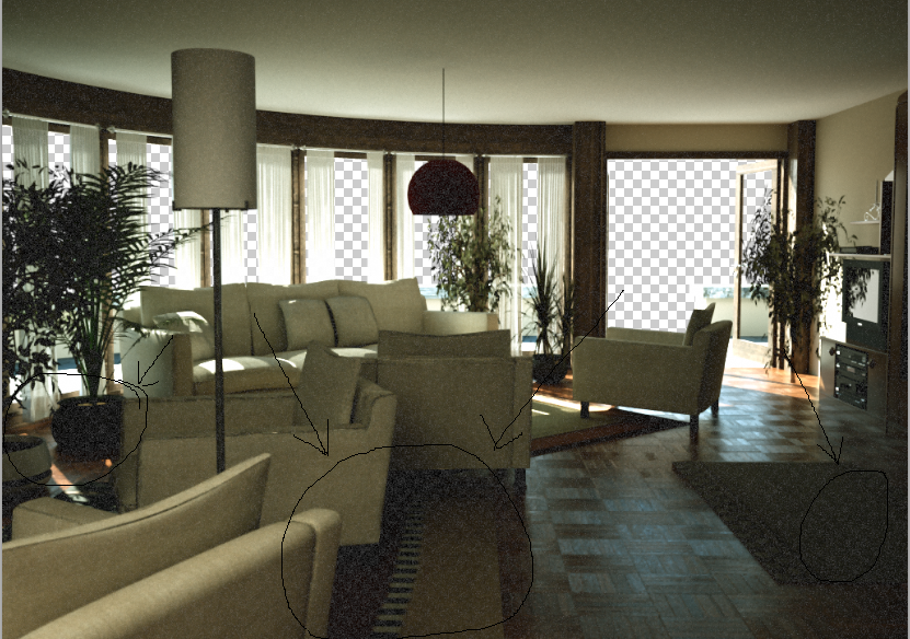

Yes, we are still fighting with alpha in the PMC kernel. In the current system transparency should go away after a while. i.e. when you have enough samples per pixel accumulated.ribrahomedesign wrote:Hi there.
alpha channel seems to be still broken ,the whole image is slightly transparent not
just the background .
Cheers,
Marcus
