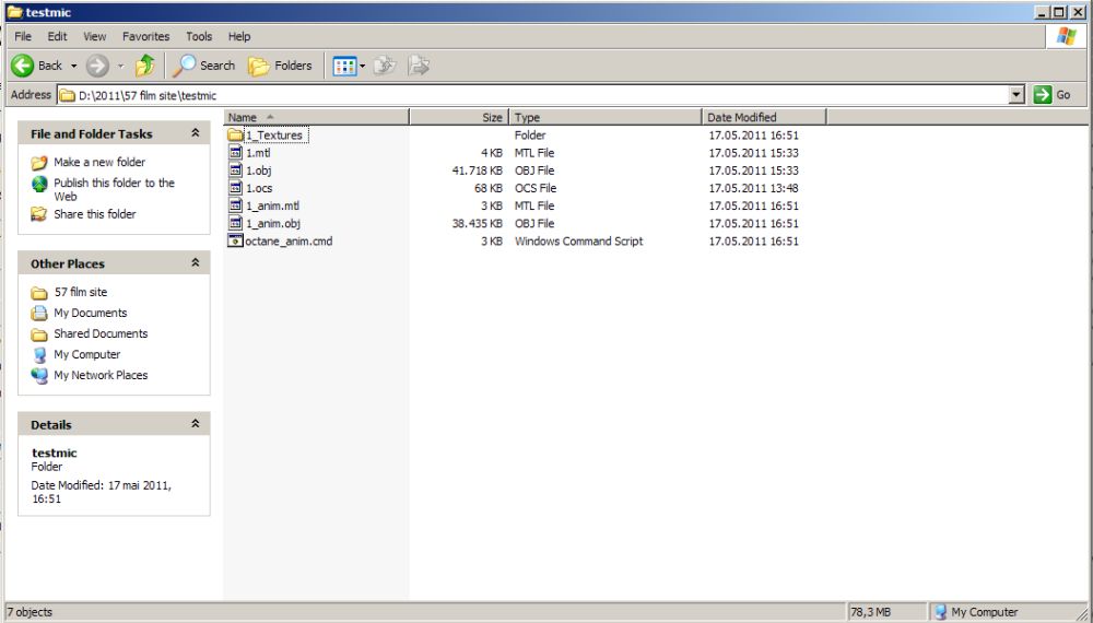

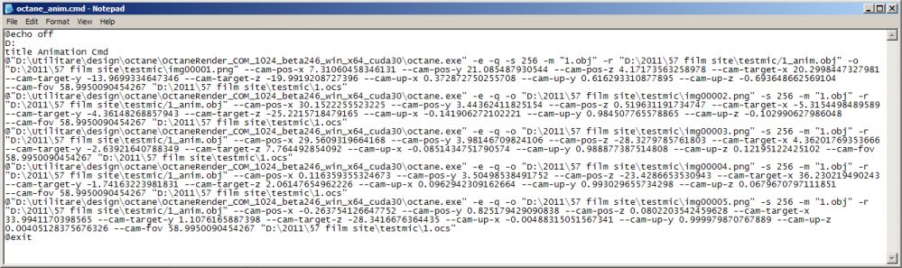

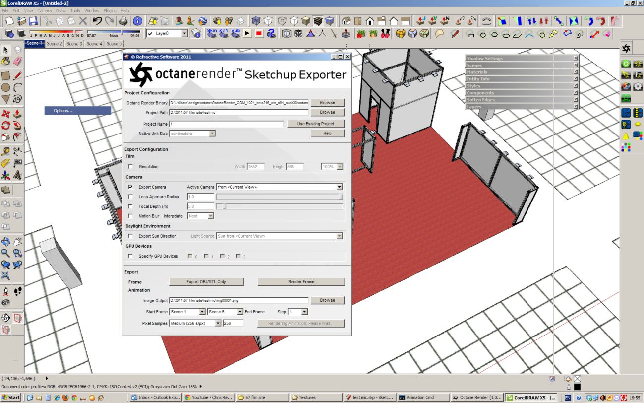

i'm having the same problem with automation error.
i have tried a small test animation and i stumbled on first step ...
attached are screenshots of cmd file , folder location, skp window and error message.
i'm doing something wrong?
thanks!
thanks!

You must have initially run a Render [one frame] on the project to make the base OCS [and OBJ file for that etc] - in your case '1.ocs' and 'i.obj' etc. The animation needs these for its other settings. It then makes '1_anim.obj' to use temporarily during the animation - it is auto-deleted on completion - unlike the base '1.obj' file used for the main Render's mesh which must always be kept/updated...
Please retry and report back...

ok. now i understand. i'll give it a try tomorrow.
thanks and best regards!

all is good now.
tested and works fine.
many thanks!!!
many thanks!!!
