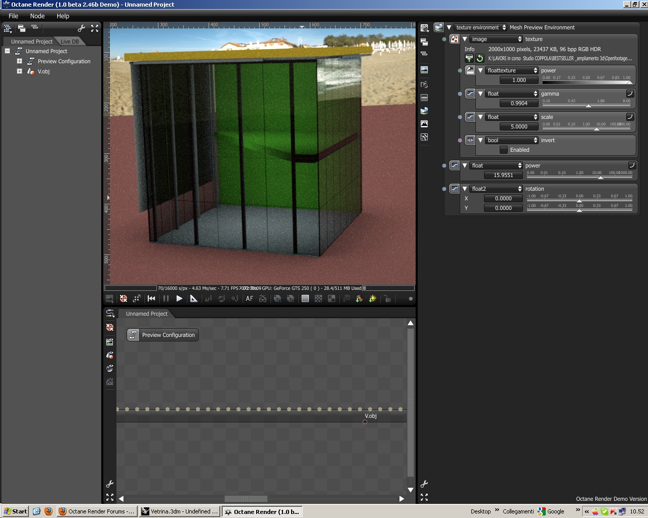

I have a question:
it is normal that the sunlight does not pass through glass?
I add a picture showing how the sun does not creates shadows-lights inside the building...
I use pathtracing kernel...
Thank's

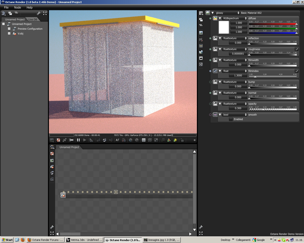

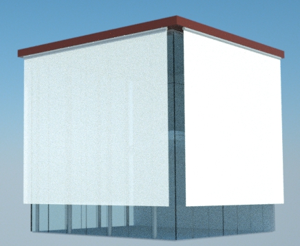

hi mib
I try to do what you say but the result is bad
1) whit hdri ther's not sun into my object, there's not shadows in all render!
2) whit glossy material the glass is not clear but is white
Where i wrong if i wrong??
Is a big problem for exterior renders!!
