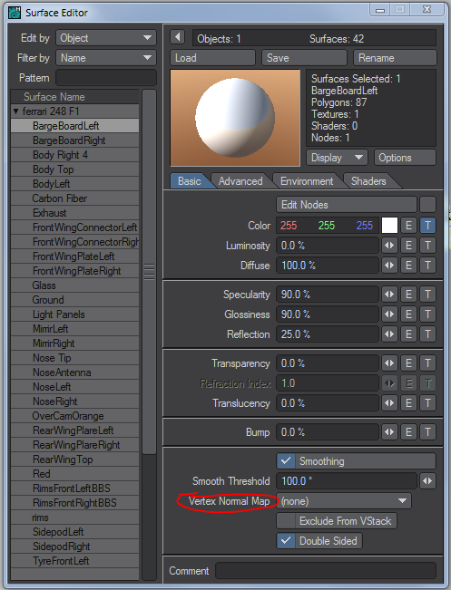

In this case it seems to be related due to missing smoothgroup information.
Can you split your model vertices based on normal angle ?
Or, try importing with with the options in octane's settings to recompute smoothgroups.

Hi thanks for the response!radiance wrote:Hi,
Radiance
Unfortunately I have not a clue what you mean by "Can you split your model vertices based on normal angle ?". I'm fairly new to 3D. But I will try looking around on google to figure out this lingo.
- Manveer Dhillon
- Posts: 28
- Joined: Sat Oct 02, 2010 1:03 am
Guys I promise you it's just a question of it not baking the subdivision into the mesh - it's not smoothing groups, it's actual subdivision smoothing that for some reason isn't being imported - I dont use LW but look on google for baking/collapsing/exporting sub-d meshes - you can see on the "smooth" version that there are far more polygons in the mesh..
Sorry, that is not the case.... no matter how subdivided the model is, it is faceted in Octane through the exporter, even when the model is so subdiveded that you can not see any polygons any more. It is a problem of the exporter, that is my impression...p3d wrote:Guys I promise you it's just a question of it not baking the subdivision into the mesh - it's not smoothing groups, it's actual subdivision smoothing that for some reason isn't being imported - I dont use LW but look on google for baking/collapsing/exporting sub-d meshes - you can see on the "smooth" version that there are far more polygons in the mesh..

Are you changing display subPatch level in layout or freezing the model to polys in modeller? If in layout, then I doubt the exporter would export anything other than the base mesh.Lutze wrote:Sorry, that is not the case.... no matter how subdivided the model is, it is faceted in Octane through the exporter, even when the model is so subdiveded that you can not see any polygons any more. It is a problem of the exporter, that is my impression...p3d wrote:Guys I promise you it's just a question of it not baking the subdivision into the mesh - it's not smoothing groups, it's actual subdivision smoothing that for some reason isn't being imported - I dont use LW but look on google for baking/collapsing/exporting sub-d meshes - you can see on the "smooth" version that there are far more polygons in the mesh..
