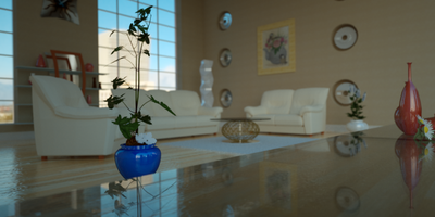

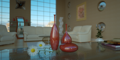

a bit more on the status update...
the rig works well... now m pretty used to it..
test renders of interiors...(free models taken from warehouse..)
rendered with pathtracing about 20min each, ~5000samples , approx. 81k triangles, 1.75-1.8 megasamples, around 3.5 samples/sec
high dof- in the foreground- intentional...to blur the low poly furniture in the background
just to test interiors out...i know it doesnt compare with the masters of archviz out there on this forum
cheers!
