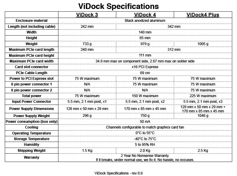

the vdock4 plus can support upto 225W power (good enough for a GTX 570..??),and seems preferable for laptops with PCIexpress slots..
and price also seems almost ok...279USD (+25USD worldwide shipping)

i think power might be a problem..
it can support max 225W as per spec sheet..
as per nvidia, max graphics card power for:
GTX 480= 250W
GTX 570= 219W (owing to new thermal design..)
GTX 580= 244W
but does anyone know more or have actually tested this product?

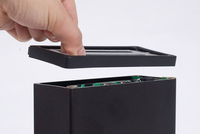

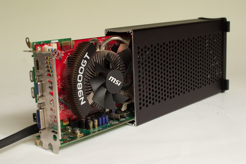

but will it actually fit? you need to unscrew the case of vidock and put the graphics card in the PCI slot inside.. and what about the heat issues?
otherwise..it seems ok for laptop users though..

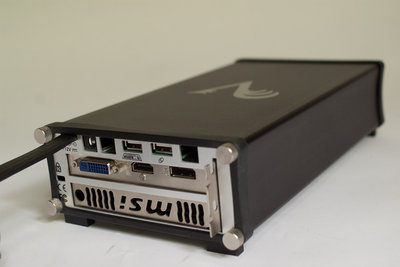

here is the reply from Vidock team.
i think its a good solution for laptops
anyone has any suggestions please do let me know
Response from Vidock:
"The ViDock 4 Plus can support a GTX460, GTX470, and the GTX560 TI or GTX570 IF they stay within the powers specifications that Nvidia has set. You will need to check the cards' specific manufacturer for full power requirement details.
http://www.geforce.com/#/Hardware/GPUs/ ... ifications
If you look, all 4 of the cards I listed above are actually below the 225Watt ViDock 4 Plus powersupply however you need to check any card specifically before you buy it. The ViDock should support Cuda fine, and we ship worldwide.
Best Regards,
Jim Atchue
We hope this response has sufficiently answered your questions. If not, please do not send another email. Instead, reply to this email or login to your account for a complete archive of all your support requests and responses."
