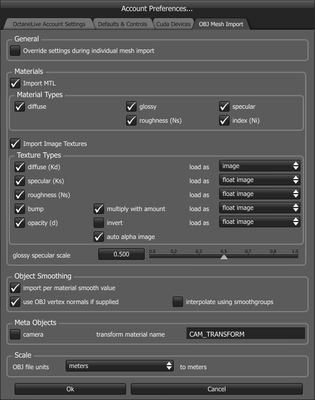

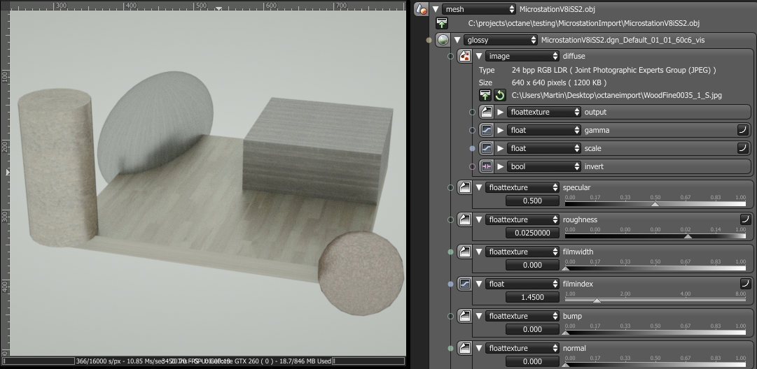

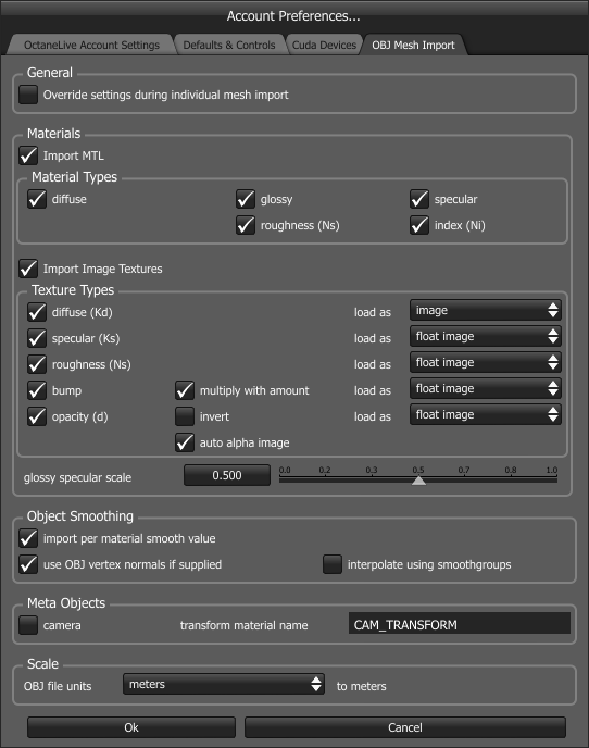

Ok, tried it and it worked in Octane beta 2.44. This is what I did:
- I unpacked your RAR files into a directory.
- Then created a folder c:\Users\Martin\Desktop\octaneimport and copied all texture files there. (The MTL file requests the texture files from there, for example:
- Then I launched Octane and imported the mesh, by creating a new mesh node and selecting your OBJ files.
- This is what you get after enabling object smoothing (which was not turned on in the OBJ files): Maybe your OBJ import preferences are not the default ones? These were the OBJ import preferences I used: Other than that I have no idea what else might go wrong here.
