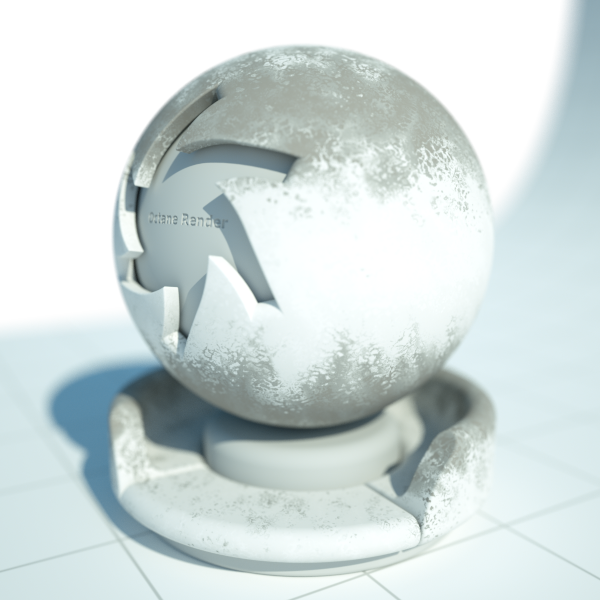

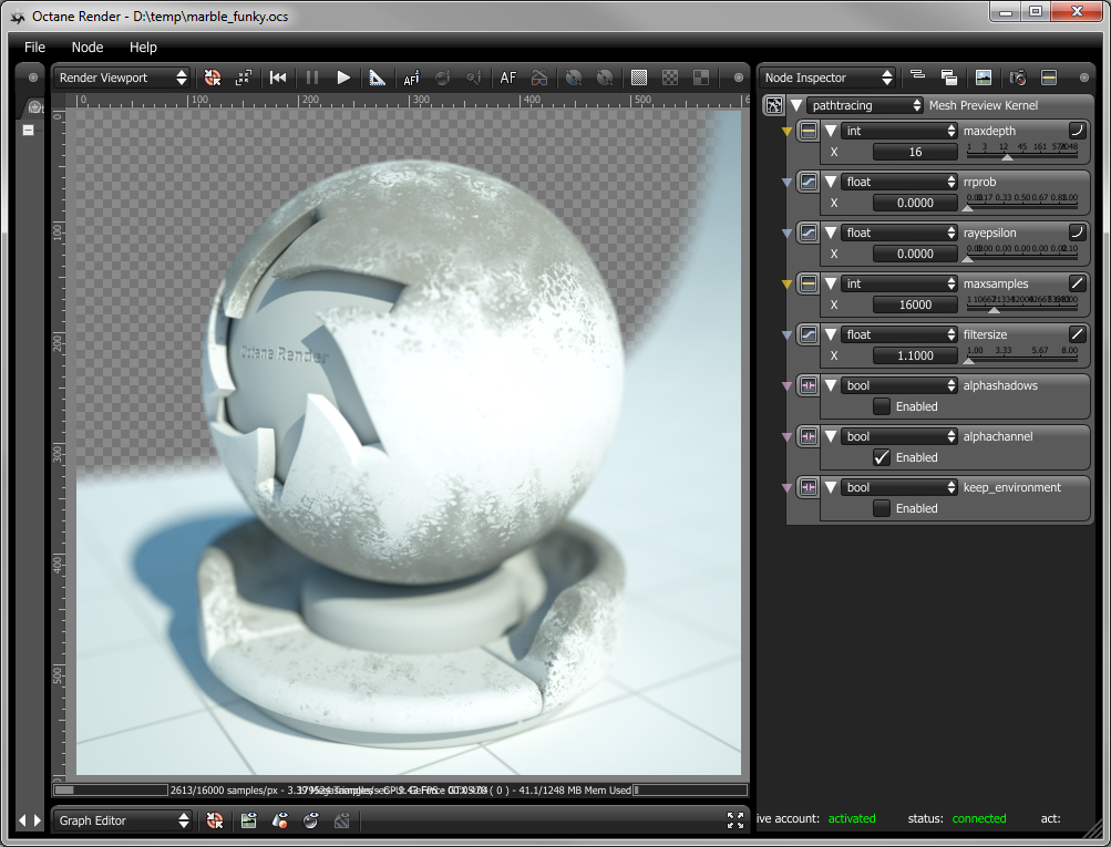

With version beta 2.4 you can render the scene with an alpha channel, which allows you to add a different background afterwards. The pre-multiplied and not pre-multiplied alpha are supported. This is how it looks like in the render viewport:
And this is the rendered image:
Cheers,
Marcus
