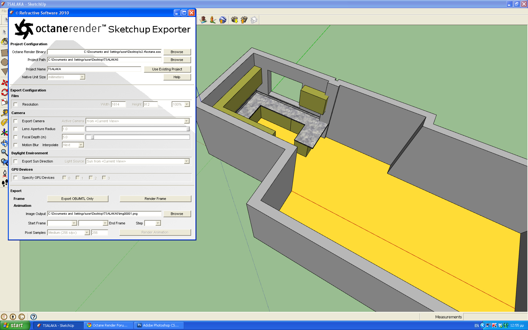

I tryed also the 1022-12 vertion, exporting the camera or not i have no geometry on octane. ?????
This is what i get.

Postby TIG » Thu Jan 27, 2011 2:38 pm
TIG Thu Jan 27, 2011 2:38 pm
Use the latest version of the exporter.
If you do not export anything all you get in the export is the OBJ/MTL/Textures.
The OCS opens using the default camera placed/looking at the origin, also there is basic lighting set.
Try exporting it again with export-camera [say 50% resolution for speed] and export-lighting both checked.
See what happens...
After you have the view/lighting as wanted in the OCS you can uncheck those options and export just the current geometry and new materials...
