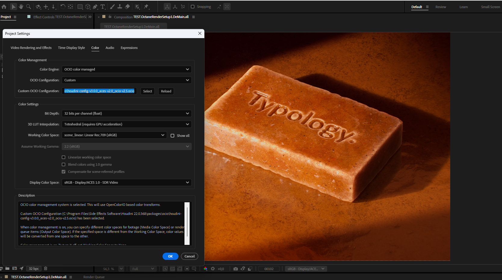

One thing we can try is loading the same Houdini configs in After effects or the external config from the AE project settings.
Houdini config is saved under this path `C:\Program Files\Side Effects Software\Houdini 22.0.459\packages\ocio`
or match the AE color engine to OCIO color managed.
Let us know if this fix the issue!!

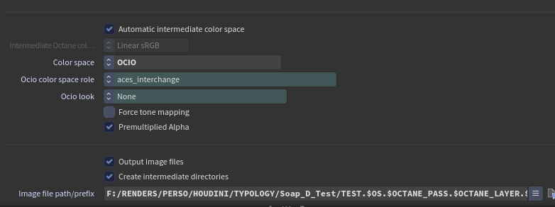

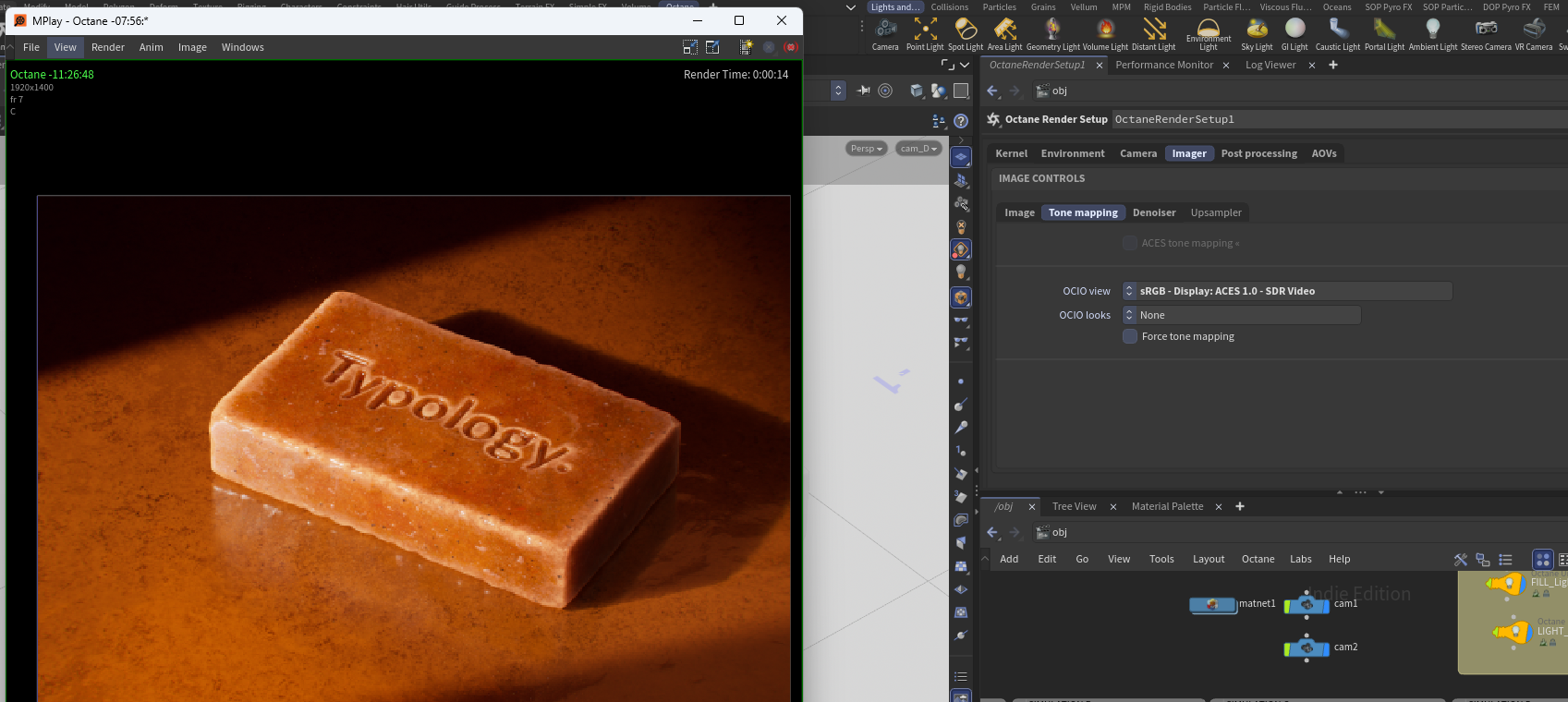

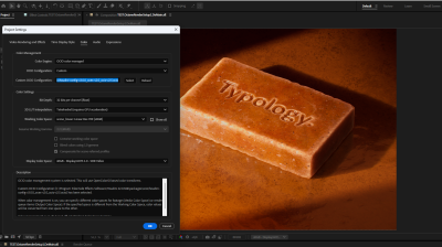

Hello everyone,
Thanks to BK i've finally got a nearly perfect match between Houdini and After Effects, here is the setup :
