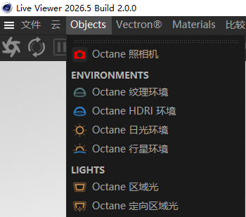

I noticed one small UI inconsistency in OctaneRender 2026.5 / Cinema 4D Plugin 2.0.0.
In the Live Viewer Objects menu, the Octane Camera entry still appears to use the old camera icon design.
Since Plugin 2.0.0 introduced the new icon style for Objects and Tags, the Octane Camera icon now looks inconsistent with the rest of the updated UI.
It seems this icon may simply have been missed during the icon update.

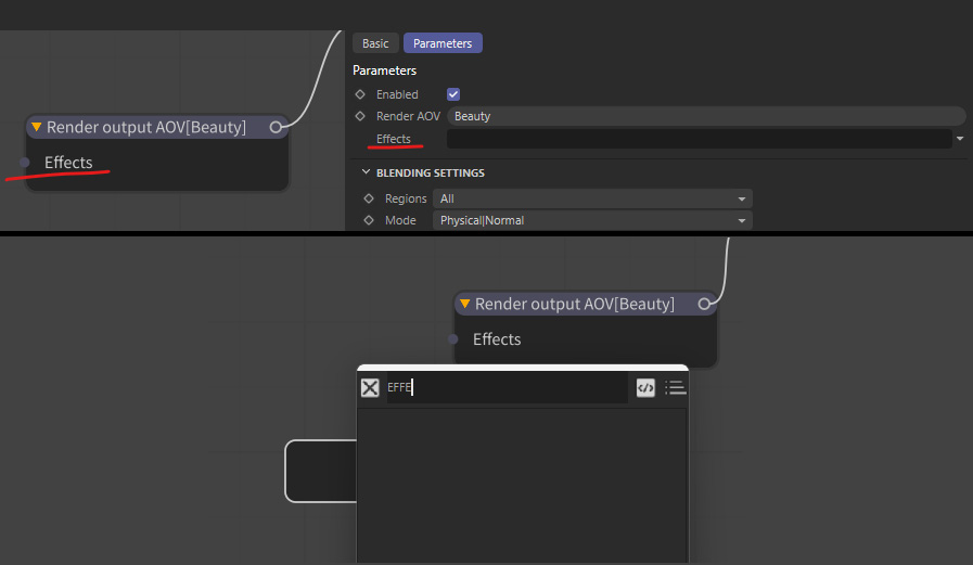

ChrisHekman wrote: Wed Oct 07, 2026 2:54 pm
J.C wrote: Wed Oct 07, 2026 9:02 am It's not possible to add more layers in effects input of an AOV Blend node. You can only add one effect now while in Standalone there can be multiple layers.
Could you provide a screenshot of what it is specifically which node doesnt work?
It's not possible to add Effects layer node to existing node graph:
The Effects layer node automatically appear only when adding ADV node.
CPU – i9 13900KF, 128GB RAM, GPU – RTX 4090
System – Windows 11
My Behance portfolio, Blender plugin FB support group

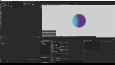

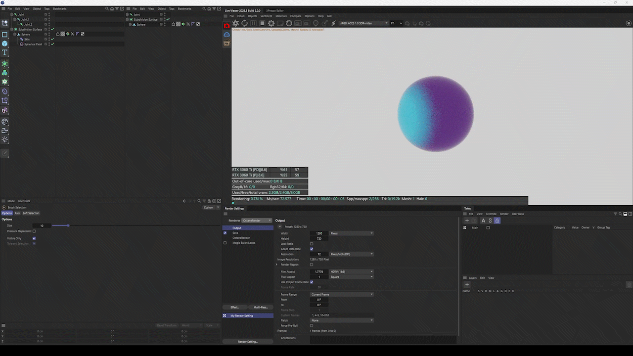

I'm currently fighting one of these cases where the LV constantly restarts a rendering, making it frustrating (a bit of a dice roll) to preview render some scenes.
From what I can tell, this particular case seems to be related to the combination of Vertex Maps on skin deformed geometry? Noticed it on a larger project, but recreated the issue in a basic scene:
(This is an animated gif, but only seems to play when opening it in a new window. In any case, the C4D file is attached as a zip)
Basically, this is a sphere with a skin deformer and some joint weights, there is a Vertex Map Tag using a Spherical Field, and the Vertex Map is used in a Comp Material to mix a purple and a blue material. Also applied an SDS, so it is closer to a production-like setup.
The constant restarts don't happen on every single render attempt, but rotating the cam a bit with nothing selected should trigger them. Disabling "Check Geometry Updates" in the LV seems to prevent the issue from happening, but this is not really an option for animated scenes.
I regularly use vertex maps for blending between materials (just didn't manage to pinpoint the issue before), so any improvement here would help me a ton. : )
Vertex Update Issue.zip
(85.27 KiB) Downloaded 20 times
Posts: 10643
It seems related to Bone/Skin, if you disable/re enable the Skin object it stops to blink, can you confirm?
ciao,
Beppe
Tim0042
Posts: 62
Joined: Fri Sep 06, 2019 8:57 pm
Location: Hamburg
bepeg4d wrote: Mon Oct 12, 2026 3:02 pm Hi,
ciao,
Beppe
Hey, thank you for checking! And yep, so it seems like deformers in general might be a factor? Disabling Skin stops the restarts, but adding e.g. a Displacer with a generic noise or a Bend deformer with a bit of strength brings it back. In the Bend deformer test the blinking did calm down eventually, whereas with Skin I've had cases where it never does unless I interact with the LV again in some way. So maybe its most noticable for Skin?
Removing the Vertex Map Tag seems to stop this as well, same for removing the Material tag with the mat that references the Vertex Map.
However, keeping everything and only removing the reference to the Vertex Map from within the material did not do the trick. Which I find confusing. But this is a bit tricky to test because sometimes it only shows up after moving the camera, sometimes resetting the render data helps,... Not sure. =/
