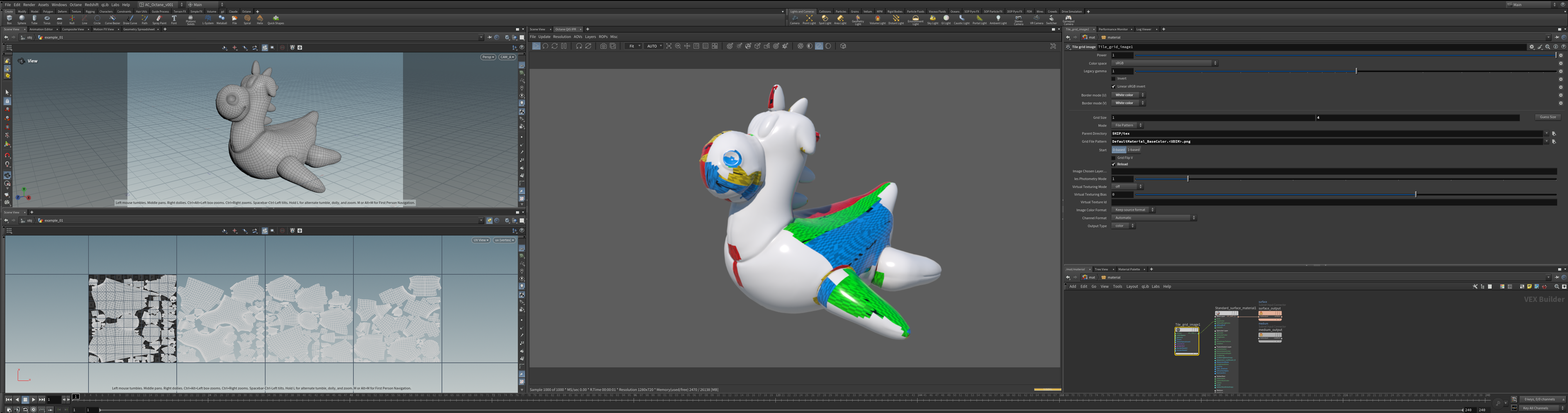

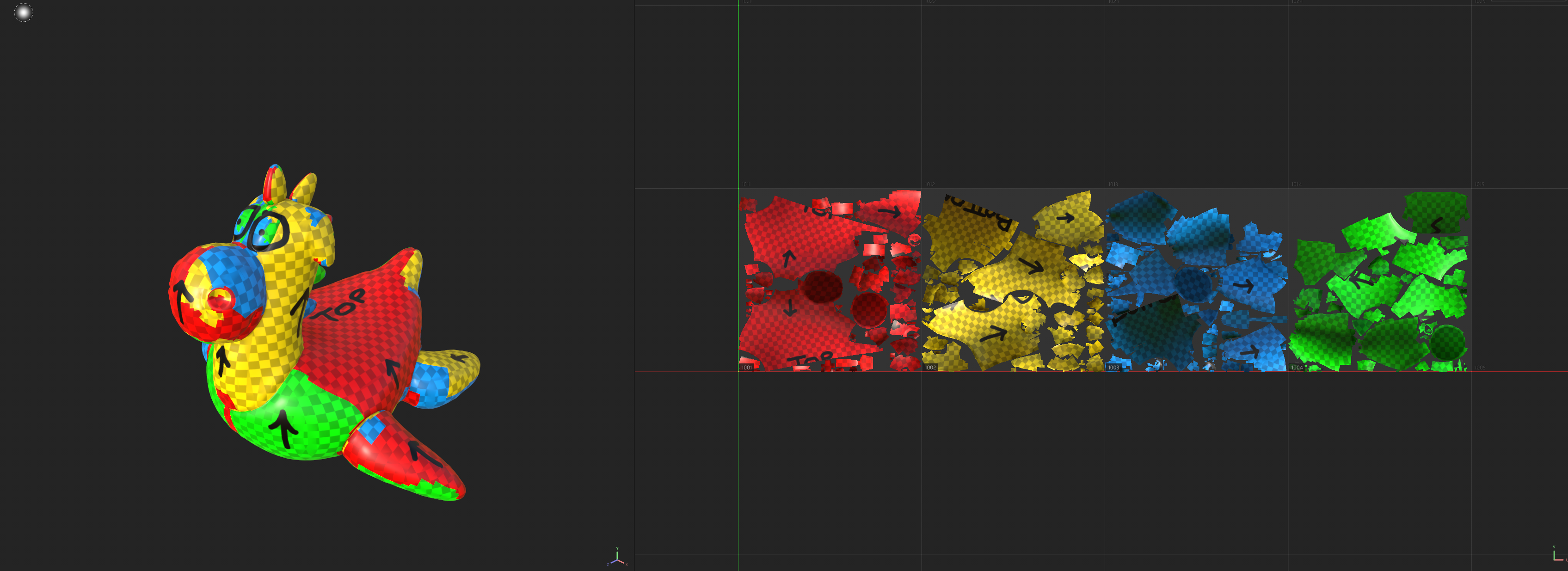

I can't get UDIMs to load correctly in the "Tile_grid_image' rework.
I've setup this basic example scene, with simple test geometry that has four UDIM tiles (1001-1004).
The model has been exported to Substance Painter, where a corresponding BaseColor sequence has been generated.
I've tried both File Pattern mode and File List, to no success. Also, clicking 'Clear' when in "File List' mode results in a Houdini crash, consistently.
Signs point to a bug where the sequence is being loaded, but compressed and applied to grid 1001, rather than properly distributed to all four tiles.
Houdini Version: Houdini FX 22.0.429
Octane Version: 2026.5.0.0
Octane_UDIM_Troubleshoot_R1.zip
(5.56 MiB) Downloaded 19 times
