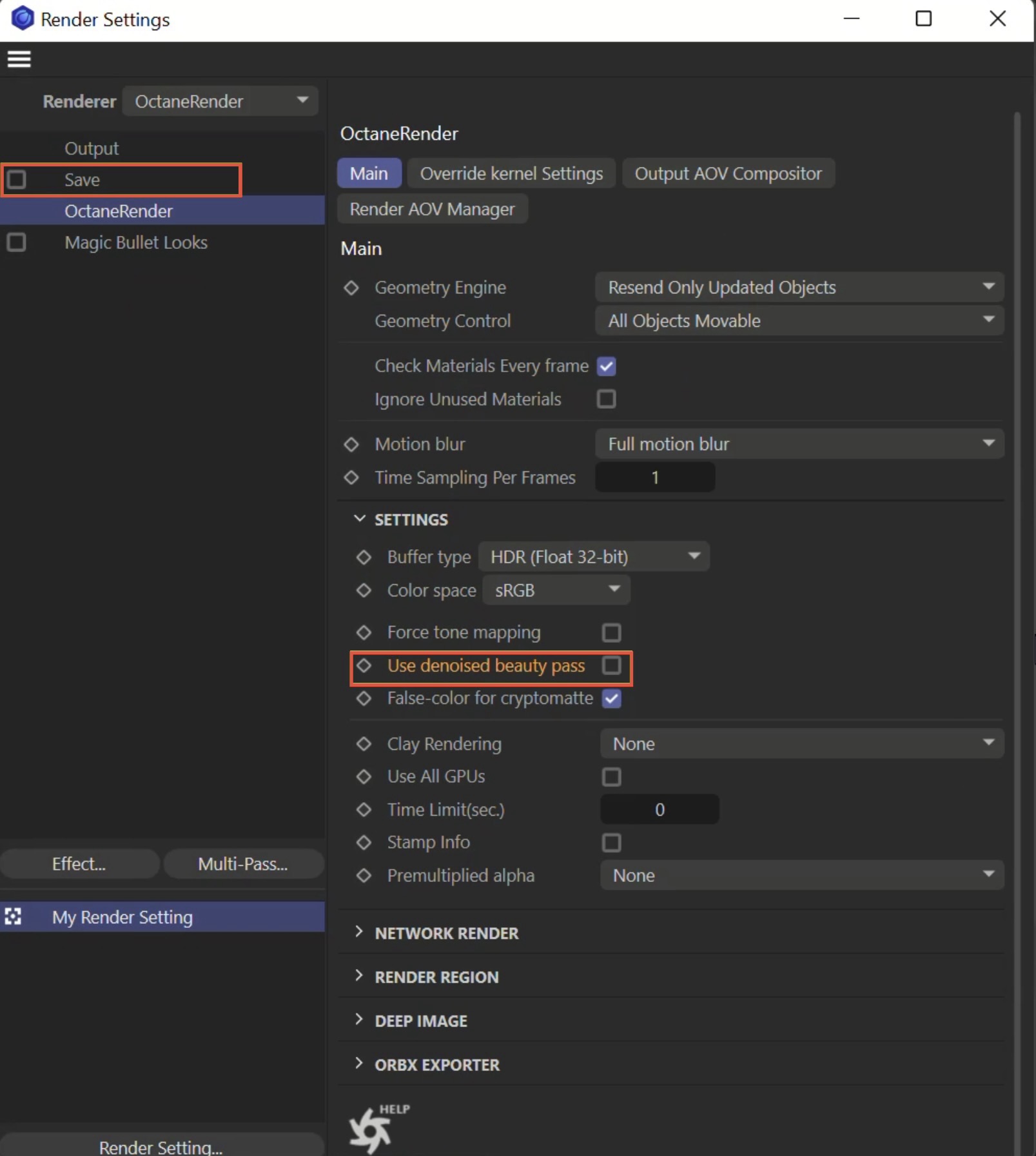

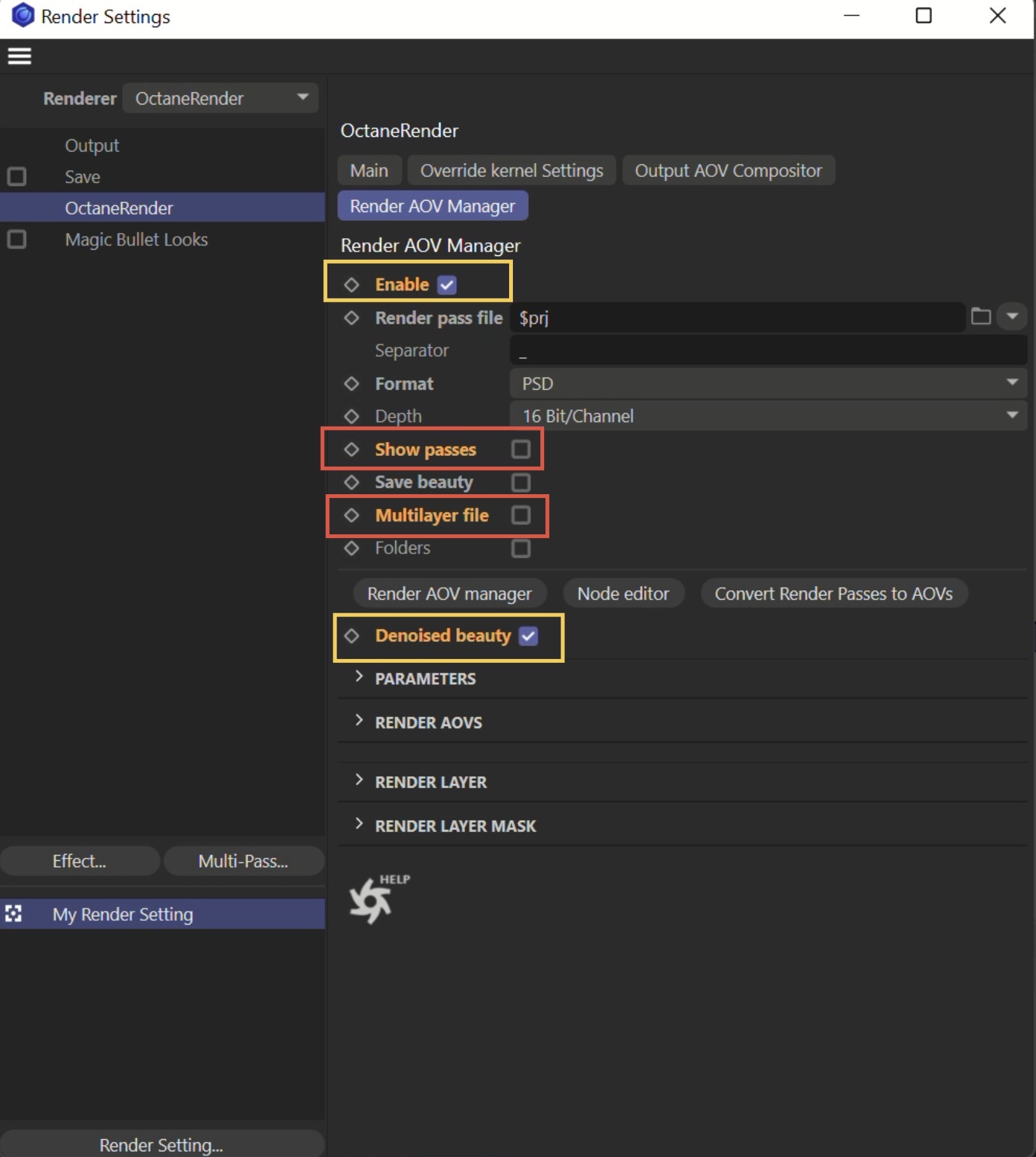

Unfortunately it is a know issue caused by ComfyUi, it interferes with OPTRIX in Nvidia driver, and the only solution for now is to format and reinstall from scratch.
But there is a workaround, if you disable C4D Save option and "Use denoiser beauty" in Main tab: Then, in Render AOV Manager tab, you disable "Show passes" and "Multilayer" options, while enabling the "Denoised beauty" option: You can render with denoiser without crashes.

Hi Bepe,
Disabling the Cinema4D save works. We're rendering through deadline, so we don't need to see the passes in the Picture Viewer and we don't use multilayers anyway so in the end it isn't that much of a difference for us for now.
Thanks for your quick help.
