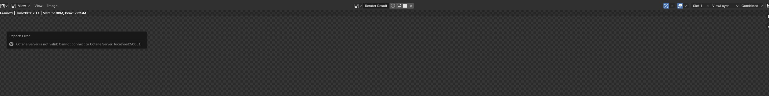

when rendering a larger image this error message pops up!
Blender 5.1.2
Server is: Server Studio 31.9
Octane Addon: 2026.3 31.9
So this should be the right server.

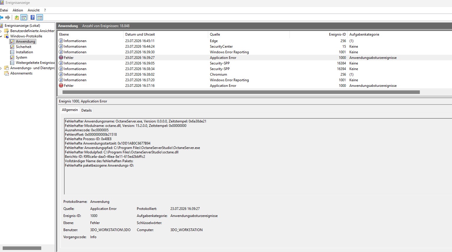

The log only confirms that Blender loses its connection to Octane Server; unfortunately, it does not reveal why the server stops responding. Please check Windows Event Viewer → Windows Logs → Application for an error involving OctaneServer.exe at the time of the crash, and share the faulting module and exception code if available.

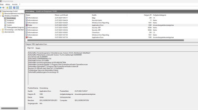

you mean this?
regards
Michael
linograndiotoy
Posts: 1538
Hi Michael,
Thank you, this is more useful. It confirms that OctaneServer.exe is actually crashing inside octane.dll, with exception code 0xc0000005, indicating an access violation.
Unfortunately, this still does not identify the underlying cause. Please continue testing with all other add-ons disabled. Testing the ORBX asset in a clean scene would also be particularly useful.
