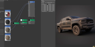

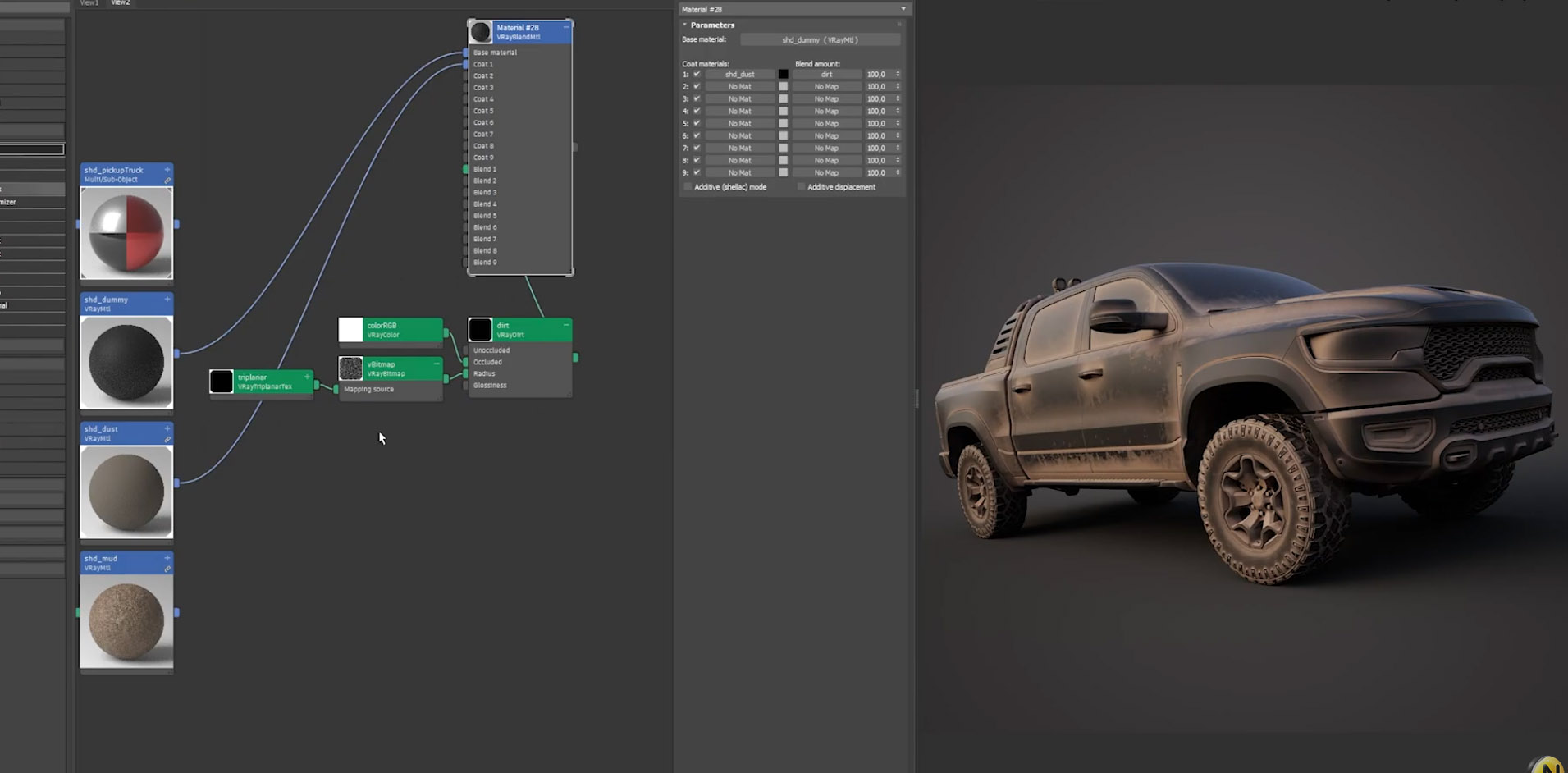

By the way, was this ever added? I thought I saw a post where it was added viewtopic.php?p=443422#p443422neonZorglub wrote: Sun May 17, 2026 10:42 pmHi coilbook,coilbook wrote: Sat May 16, 2026 8:44 pm Hi,
is there anyway to add octane volume mesh as custom reference object inside tyflow?
No, not currently. I'll ask the engine team for a future addition.
That would probably be using the 'Mesh volume SDF' type, and would also work for Vectron objects. but I'm not sure if that's possible..
For your previous question, the tyFlow Zenith / volume support is almost finished, and should be released soon.
Trying to achieve the same in octane like they did in vray not sure if octane can do it https://www.youtube.com/watch?v=-0Qa600Z9FM
Thank you

No, this was not added. It's a bit tricky because the expected way is a multi material with several mix materials inside. But I see that this would be very convenient if it could work the way you described. I'll try to add this in a next release.coilbook wrote: Sat May 16, 2026 8:44 pm By the way, was this ever added? I thought I saw a post where it was added viewtopic.php?p=443422#p443422
Thank you
For tyFlow volume, yes, the color channel will supported, and a tyFlow volume modifier will allow to select an octane medium and assign the channels, like for Phoenix FD volumes.
