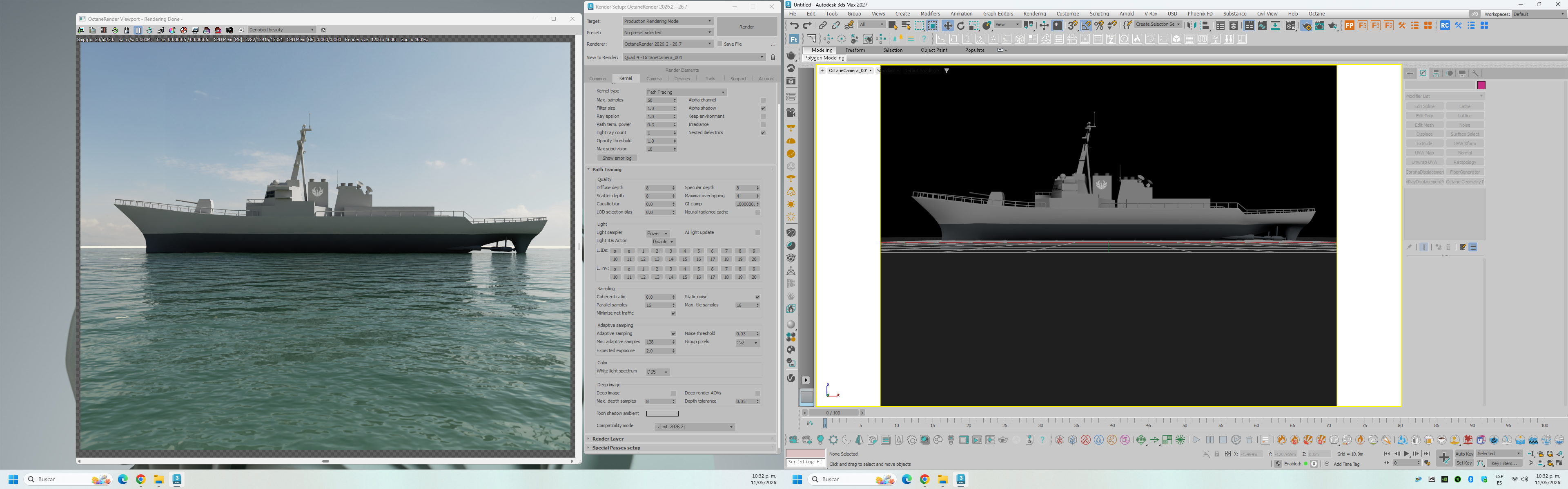

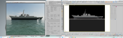

After watching several videos on creating ocean water, only one explained how to create ocean water in OctaneRender using a Vector Displacement Map texture.
Autodesk provides this map and a tutorial on how to create ocean water.
I hope the OctaneRender team doesn't censor me for sharing this image and the simple steps for creating water in CR.
https://help.autodesk.com/view/ARNOL/ENU/?guid=arnold_for_3ds_max_ax_shading_ax_ocean_displacement_html
Thanks to the OR team and parid4331 for their patience.
A simple EXR image can achieve incredible results; the key is obtaining more EXR images, like the one provided by Autodesk, to create different ocean water features.
It's a texture similar to Phoenix FDOceanTex, the colors change from the texture.
- Attachments
- oceanshape_0000.zip
- Texture Vector Displacement Map
- (3.47 MiB) Downloaded 51 times

Hi Pelana001_1,
One limitation of this texture is the level of customization it offers based on your specific needs. In this case, you can use a turbulence noise texture, which allows the texture to be easily scaled and adjusted while remaining very lightweight, since it is procedurally generated.
Regards
Paride

Hi paride4331, you're right, for creating ocean guides without being able to use the phoenixFDOceanTex map, it's a good option.
That's correct, the turbulence option improves the results.
Thanks for your input.
