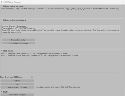

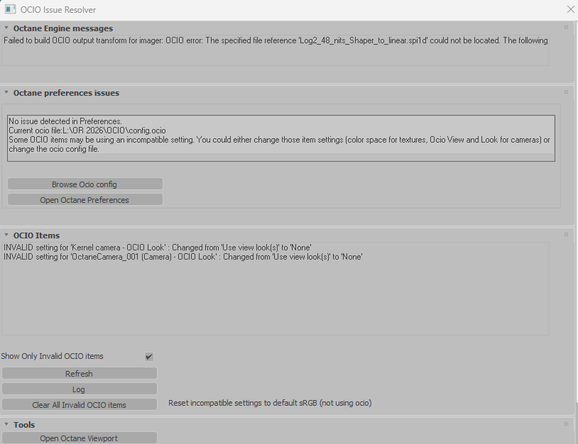

Hello OR team, I followed the setup instructions in a video to use Ocio, but when I select the Octane Viewport option, I get an error message.
What could be causing this error?
Thanks, OR team.

Hi Pelana001_1,
Are you sure you downloaded the right library and set up all the OCIO package folders correctly?

Hi, I downloaded the file from the Open Color homepage, here's the link.
https://opencolorio.readthedocs.io/en/latest/quick_start/for_artists.html

Hi Pelana001_1,
https://github.com/AcademySoftwareFoundation/OpenColorIO-Config-ACES/releases
cg-config-v2.2.0_aces-v1.3_ocio-v2.4.ocio
