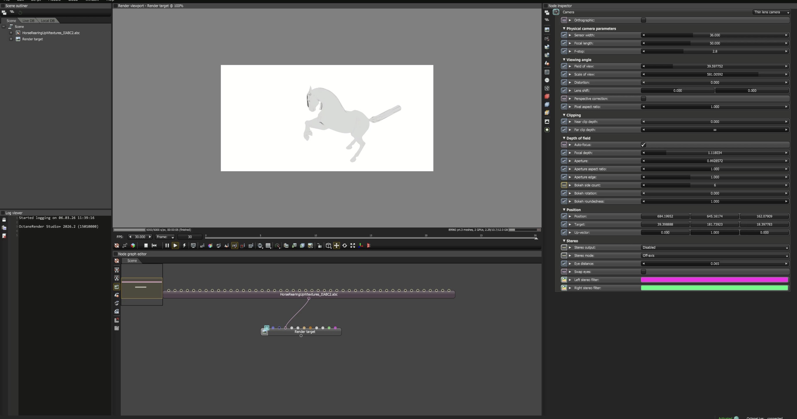

I have an ABC file in the standalone that works. Yaaaaa!!!
(I have tried IMPORTING the same ABC file into blender and maya and it is unable to import. This could be because the abc exporter from Daz Studio 3d is a bit flakey :>)))) So I am guessing the Daz "type" of abc file is compatible with octane standalone but not other apps.
So I thought I would try exporting (the abc that works in the standalone)... out using the geometry exporter node/script:
I saved out to an abc and fbx Sucessfully
Then re-import them to octane standalone, maya and Blender as a test (They successfully come back in all the apps) but they only export a file abc or fbx with no animation.
Any ideas mate? (Put the orbx file in here if it helps)

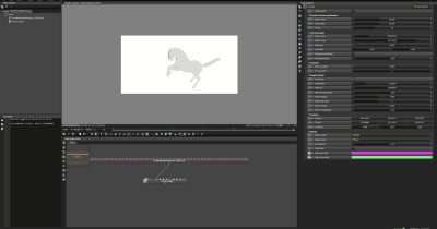

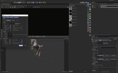

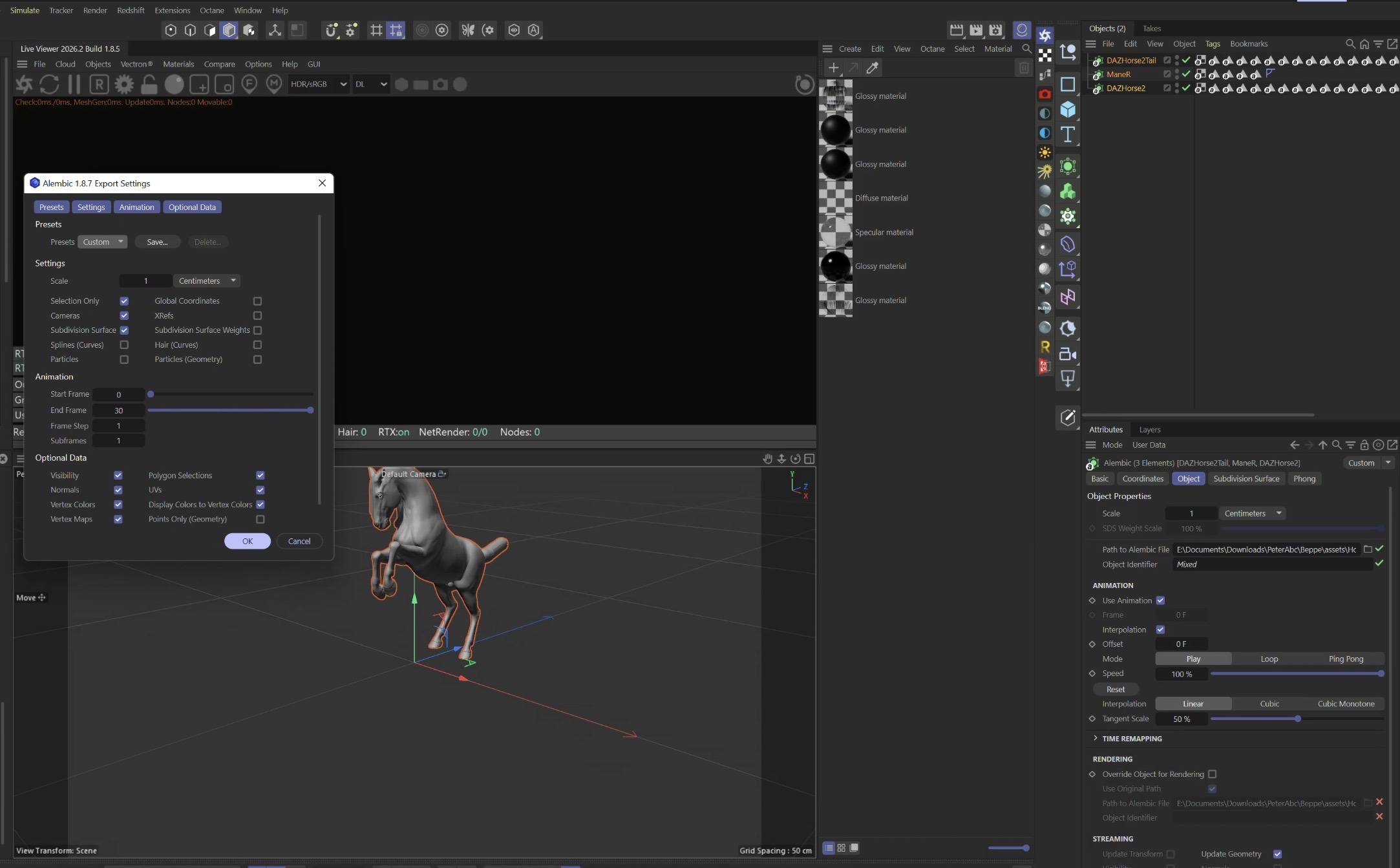

Your ABC file is opening without issues in C4D, so I have exported it again in ABC format from C4D:
Then imported back in Standalone without issues:
Please try with the following version and report back, thanks:

If you unpack the latest .orbx scene I have shared, you get the horse exported from C4D.
About Geometry Exporter node in Standalone, I don't think it is designed for animated geometry export.
Unfortunately I'm not good in Blender, but I'm sure that it can import animated ABC files without issues.
