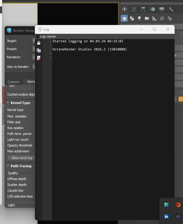

You need to enable the "Autosave Error Log" checkbox so that the user can click it and, the next time the app crashes, they can open a text document and see where Octane crashed.
I recorded the octane log on video, but in the video when 3dsmax crashes, it is empty.

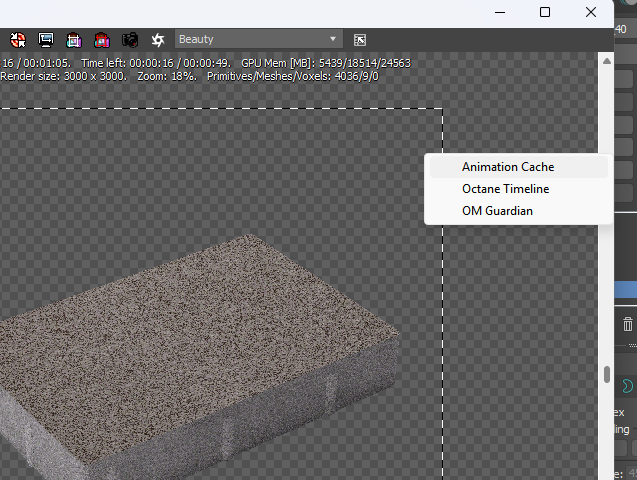

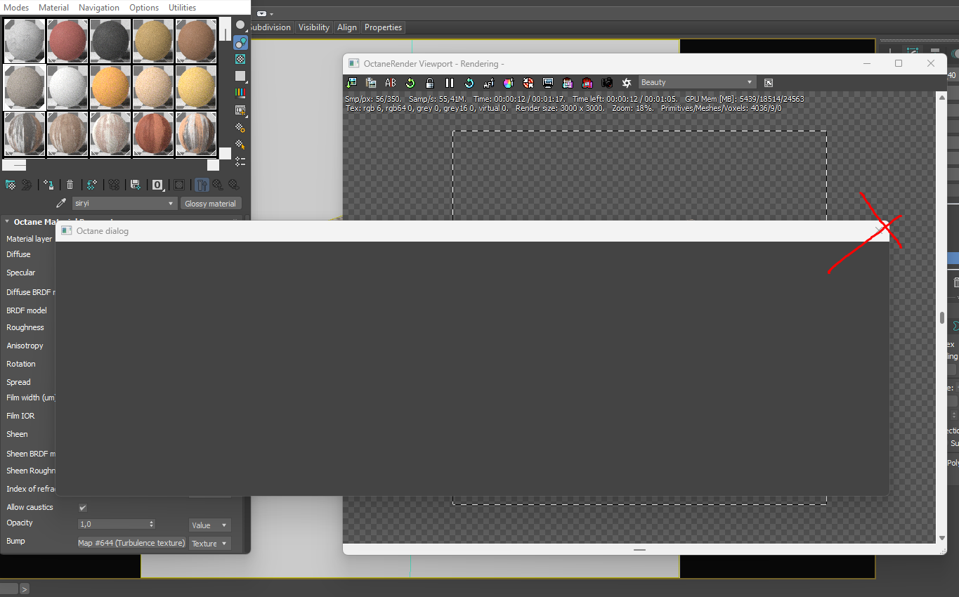

I accidentally clicked on the viewport and three functions popped up, and if you click them you can no longer close them. I had to restart 3D Max.
