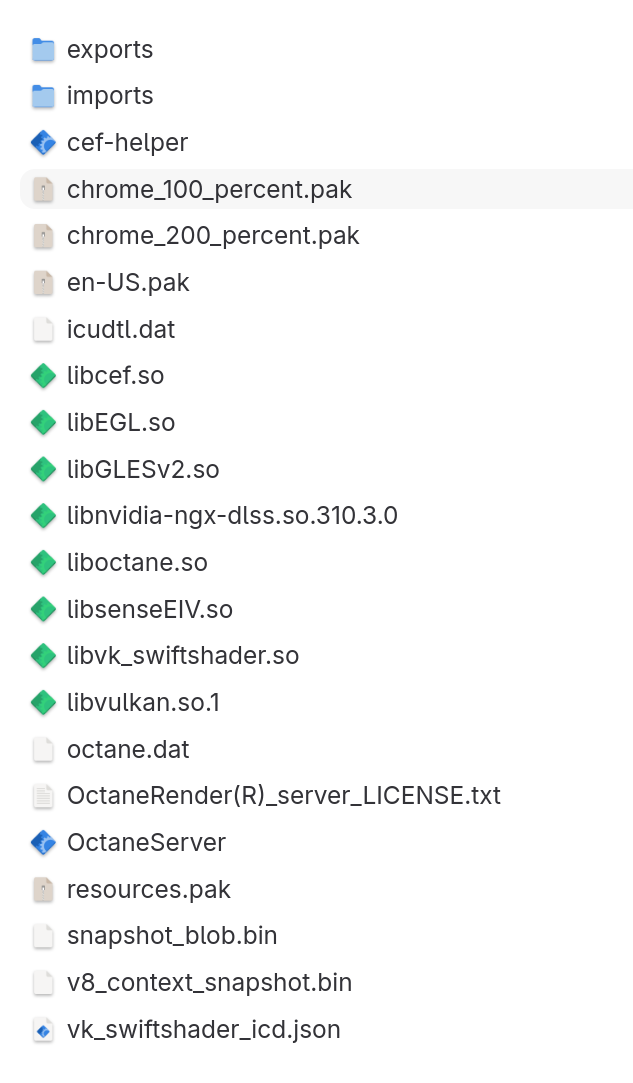

Hey Lino,
thank you for getting back to me,
I had to install the patchelf package first.
I tried patchelf --set-rpath '$ORIGIN/'lib ./OctaneServer
Probably because there is no "lib" folder in the directory. The .so files sharing the same folder with the OctaneServer
The attached screenshot shows the folder structure of the unpacked OctaneAddonServerStudio directory.
I tried altering the path to:
patchelf --set-rpath '$ORIGIN/' ./OctaneServer
and
patchelf --set-rpath '$ORIGIN' ./OctaneServer
without luck. The terminal does not provide any output and ends the program (just jumps to the next line)
