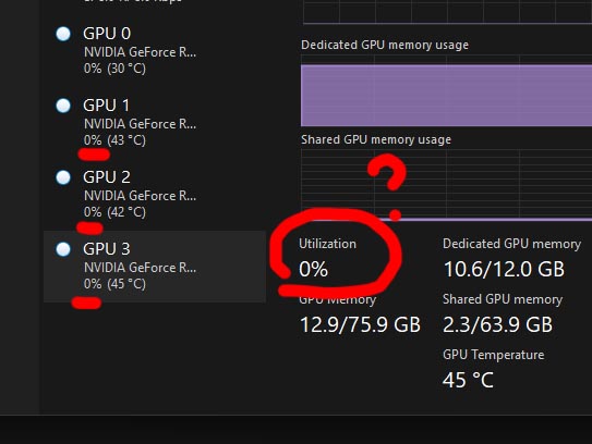

Why does utilization show 0 during rendering? GPU memory usage does work

Hi coilbook,
To obtain an accurate report of your GPUs, please use the GPU-Z tool.
Regards
Paride
