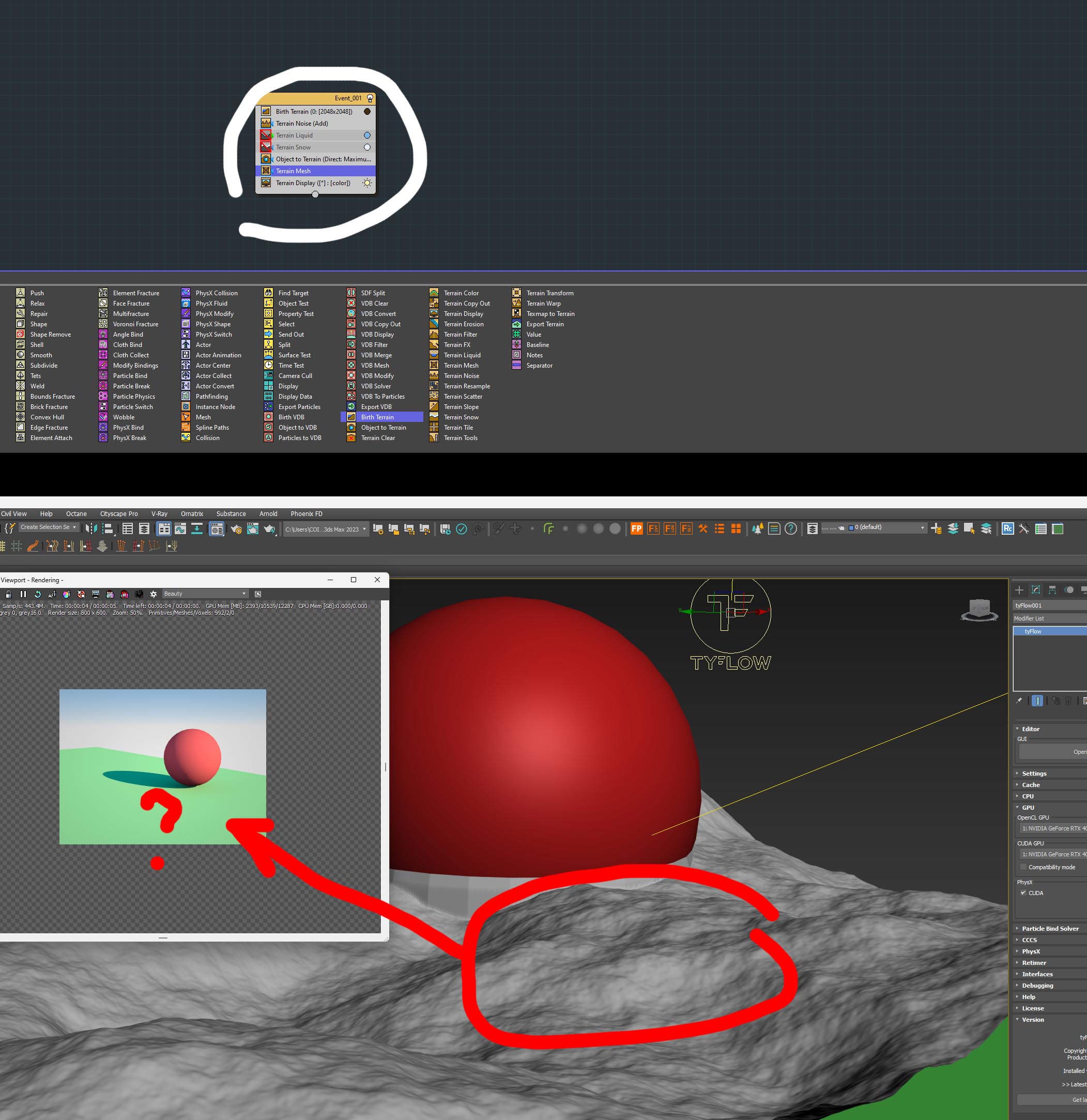

Can you please release an update so ty flow terrain will render in octane? Thank you

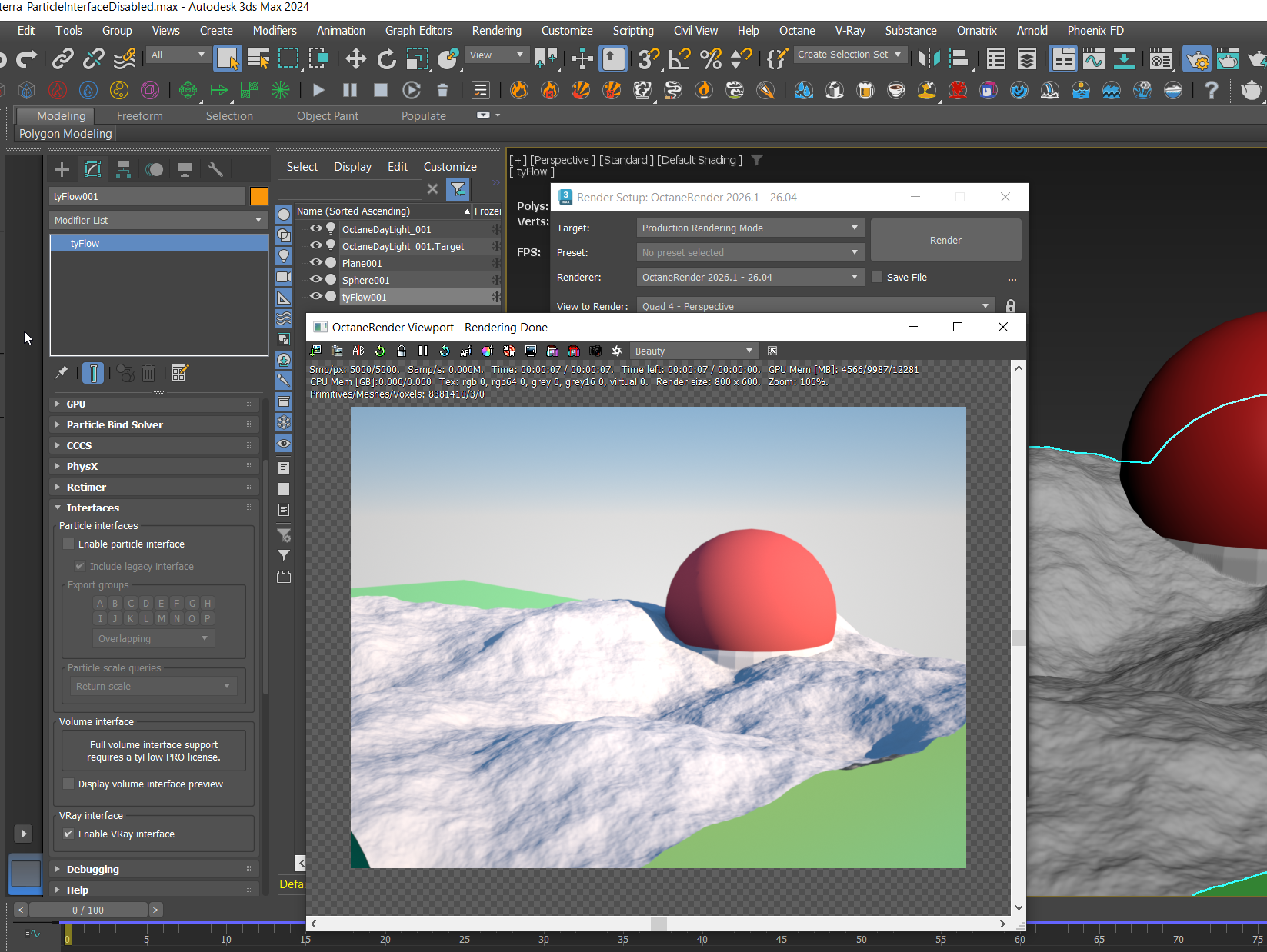

Hi coilbook,
Currently, to use a TyFlow terrain, you need to disable the Particle interface.
terra_ParticleInterfaceDisabled_mx21.zip
(122.16 KiB) Downloaded 43 times
I'll see if that can be avoided in a future release.
