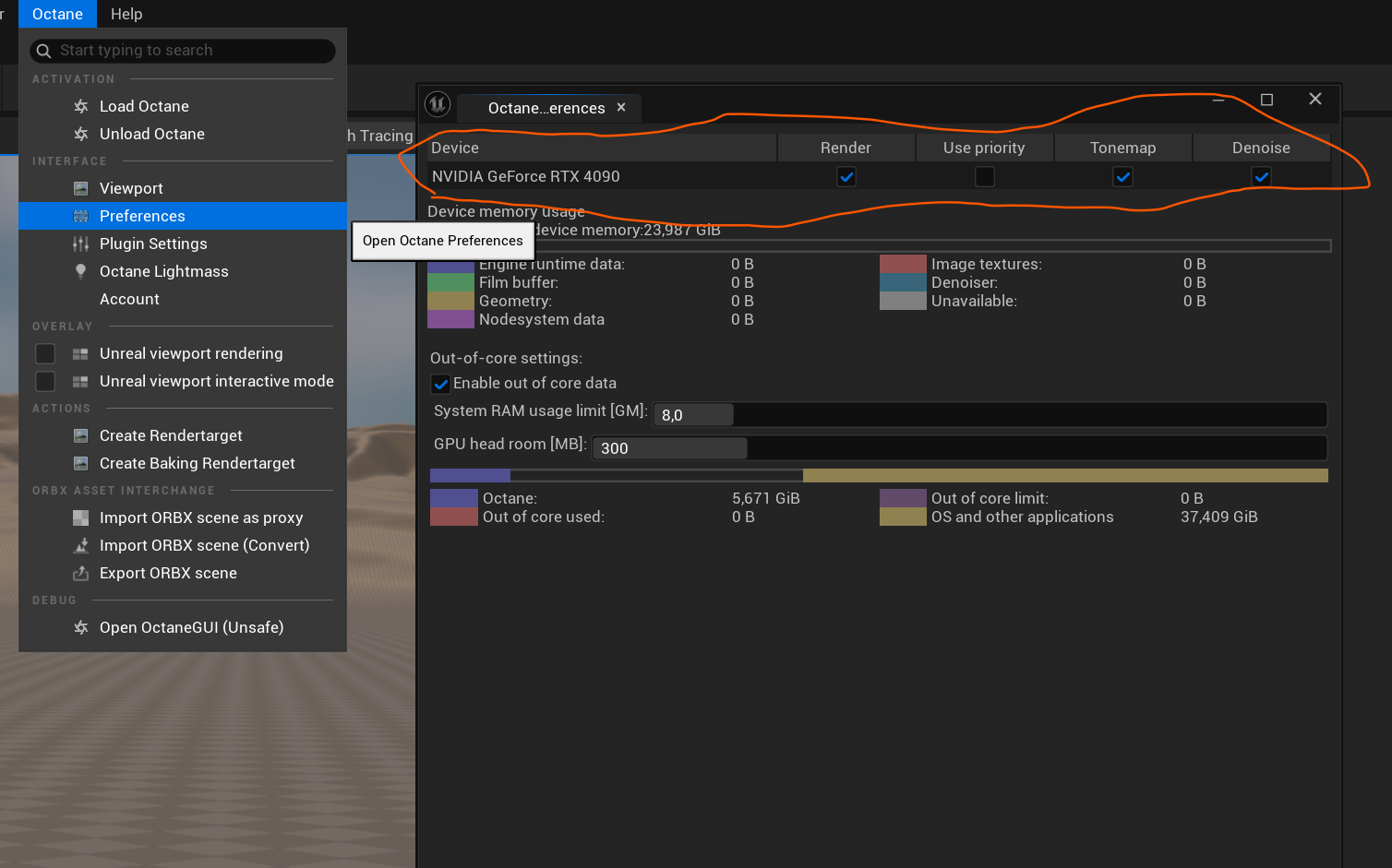

ChrisHekman
Posts: 1162
Joined: Wed Jan 18, 2017 3:09 pm
Jani wrote: Tue Jan 20, 2026 8:24 am Can I have a response from the dev please? Thank you!
You can set the device usage for octane via the preferences:
