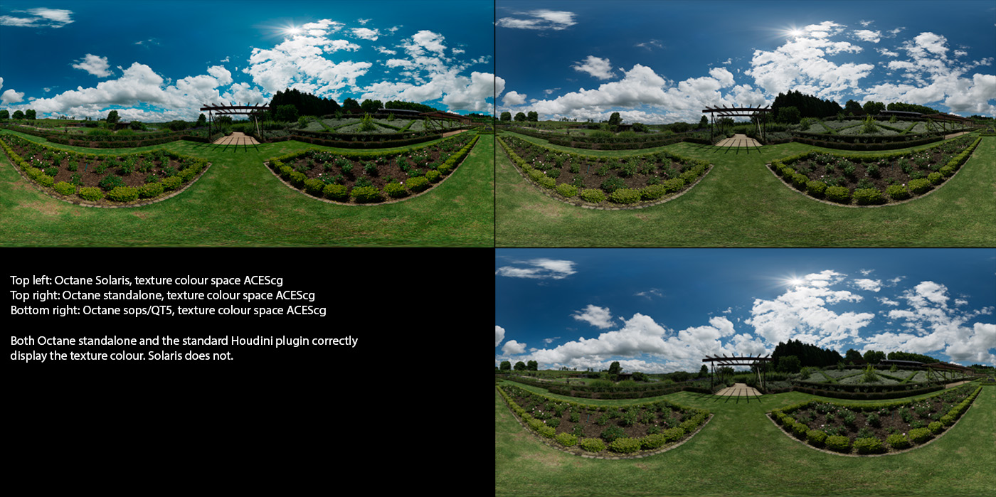

I wonder if we're talking about different things here. I have attached another screenshot.
Something is happening between the output from Octane and how that image is interpreted in the Solaris viewport. The input texture is ACEScg. It's tagged as ACEScg. Nuke displays this as expected, so does Karma, so does the standard Octane Houdini plugin and so does Octane standalone. All images are being viewed with the same OCIO config view transform. Even if Houdini itself were somehow using a different config it wouldn't explain the difference between the standard plugin and Solaris. The outlier is the Solaris viewport, which renders the image too saturated. This is not an issue limited to or related to texture colourspaces however, as you can take any arbitrary light or geometry, set an RGB value on it, and it will render differently (Between the standard plugin and Solaris, or between standalone and Solaris, either or. My previous screenshot shows this with a light).
Are you saying that on your end if you run the same image or colour through the regular plugin and Solaris that you get the same result? Because that's definitely not what I'm seeing here.

adrianr wrote: Thu Jan 29, 2026 11:42 am Hey Bikram,
To fix the Solaris viewport issue, this is what worked for me.
I went into the OCIO Editor and left the Render Working Space set to Linear, because Octane always expects linear images.
Then I changed the View Transform and set it to ACES 1.0.
After doing this, the Solaris viewport matches perfectly with the Octane viewport in the standalone version.
So try this setup and see if it matches on your side!
