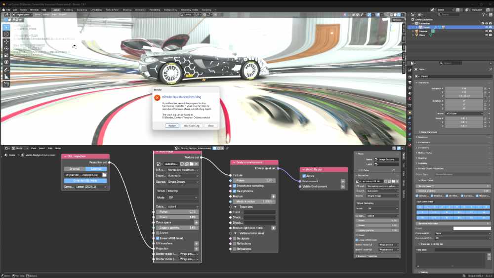

I have an osl shader / projection that was working fine on the last 3 betas of octane for blender 4.5.
When I loaded the scene and gone to world node shaders for some edit it lead to crash.
tried a few things and then I recreate the environment in a temporary scene.
when i finished and wanted to add my projection OSL that flatens ground, like a half dome projection
when i connected and compiled the shader blender crashed again.
I attached some things like osl shader and the picture that show the crash as i coonected uv projection out to projection in.
If you guys need anything else from me , please ask.

Ok, simple way to reproduce...
Add the osl I attach here,
In shader/world node an OSL Projection node as external,load it and hit compile.
HDR Ground Projection.osl
(3.19 KiB) Downloaded 39 times

In which version does it crash?

Blender 5.0 and 5.01 with octane_blender_addon-31.2-beta and octane_blender_addon-31.2-beta(6).
Not tested with one you posted today yet
linograndiotoy
Posts: 1510
OSL related nodes need several fixes, due to the changes in Blender 5.0 APIs.

It's fixed on the 31.2.1 ,but you alredy know that :D
