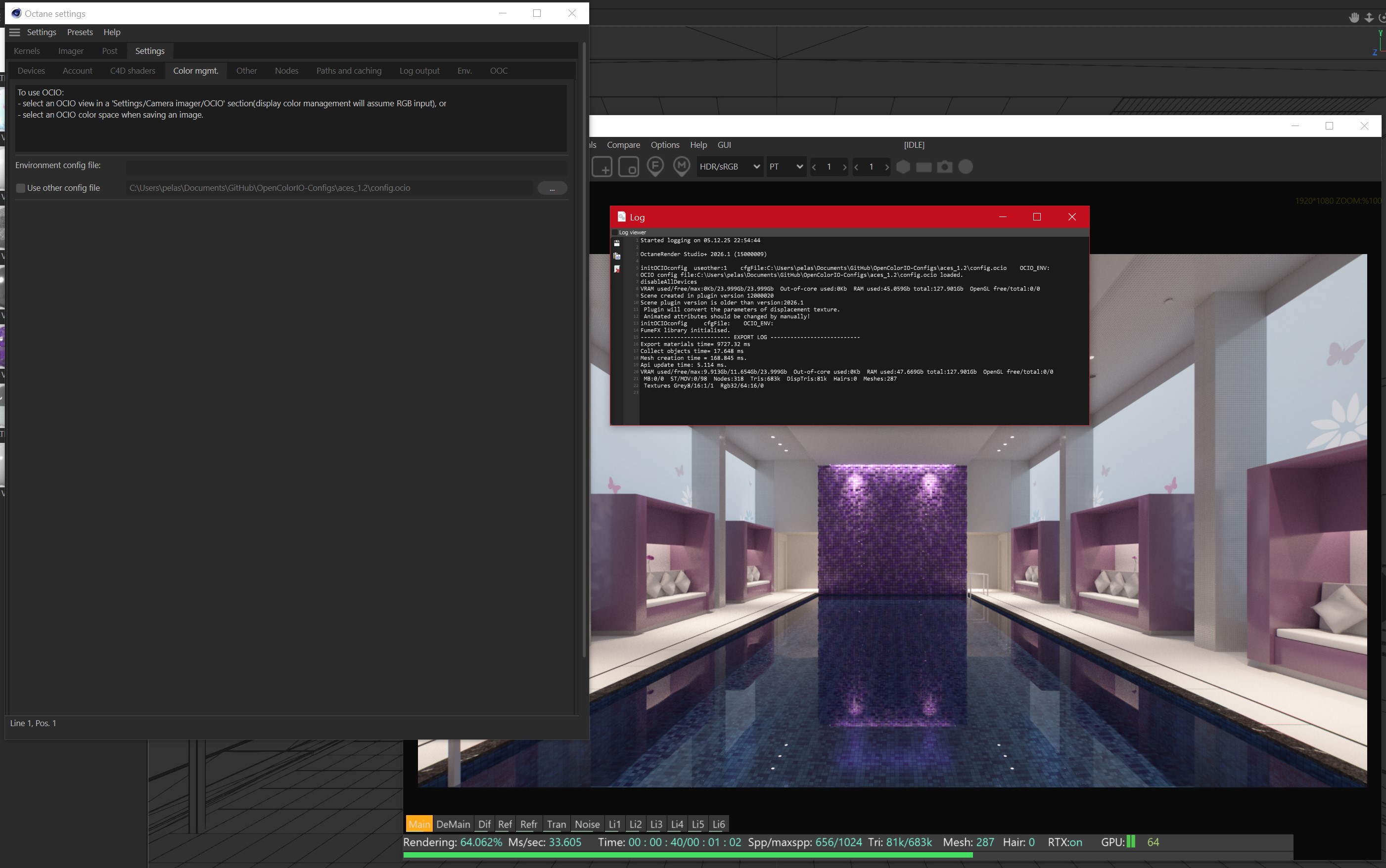

DinoMuhic wrote: Thu Dec 04, 2025 11:07 pm
Kalua wrote: Thu Dec 04, 2025 3:47 pm
bepeg4d wrote: Thu Dec 04, 2025 7:49 am Hi,
What happens if you click on the gear icon in Live View to recall Kernel settings, instead of the button/shortcut in your layout?
ciao,
Beppe
Same thing happens.
However, in this scene I particularly show now, If I open the Kernel settings window first, and hit render later, then error doesn't happen.
If I close live-view window and settings, and open again... hit render (without settings opened) I get the error again.
I saw this fail too though in other scenes.
Thanks for the report, but we will need a zipped project file with all assets from you to reproduce this, since we can't make it crash in our scenes.
Can you send it to us please?
Sure.
Already sent one to Chris.
Can send the same link to you via DM.
Have countless projects giving me this problem. Probably all my files. Haven't tried every single one, but at least 5 so far.
C4D 2025.3.3 Octane v1.9.4 // Octane SA 2026.4, Windows 11 Pro, X399, AMD TR 2950X, <<2 X 3090 + NVlink>>, 128 GB RAM, Corsair 1500i - NVIDIA SD 610.62

Kalua wrote: Thu Dec 04, 2025 11:57 pm
Same thing happens.
Sure.
I looked at the loft scene you sent.
I think the issue is your OCIO config.
In your scenes you are using a specific OCIO View, which might be not present in your current OCIO config file.
When you send the scene to the LV it checks for it, but can't render and throws an error. However after that it will reset the OCIO view and if you resend again, you will see that it will render fine.
You have the same issue in standalone if you try to open an ORBX which is using an OCIO view that is currently not present, it will throw an error pop-up indicating that.
We have this already tracked and will change the info in the LV from "Render Failure" to a more fitting error description.
So all you need to do is switch the LV back to HDR/sRGB or LDR/sRGB before you send the scene or install the same OCIO config that you used when you created the scenes.
Other then that, the scene runs totally fine on my machine using C4D 2026 and Plugin Build 1.8.1 and shows no further errors.

DinoMuhic wrote: Fri Dec 05, 2025 11:13 am
Sure.
Ok.
Will take a look.
I never had issues in Stand Alone.
But will def look into what you said.
Thanks.

Kalua
Posts: 571
Location: Caribbean Sea
Sure.
U see the issue is... I CAN render... but I CANNOT open the Kernel Render window without crashing the engine... I already shared here a video.
Am attaching it again.
Tried to reset the OCIO files and no solution, I have been using the very same OCIO files since forever. Can't understand what OCIO files are missing. And this error happens only in plugin, no errors in Stand Alone.
I also tried another scene with same error, disabled OCIO completely from Octane. As soon as I render and open the Kernel Settings Windows, crashes...
So I cannot understand how this has aything to do with OCIO.
Scene with no OCIO files loaded gives me error as I open Render Settings Window
Octane Error(1).mp4
Video of crash, it systematicaly happens in all my files.
(2.8 MiB) Downloaded 84 times
Sure.
Alright.
Whatever reason it is, I am doing what you suggested.
I can bridge those scenes to newer engine. Working now.
Will do this to old scenes that I want to work again.
Thank you.
