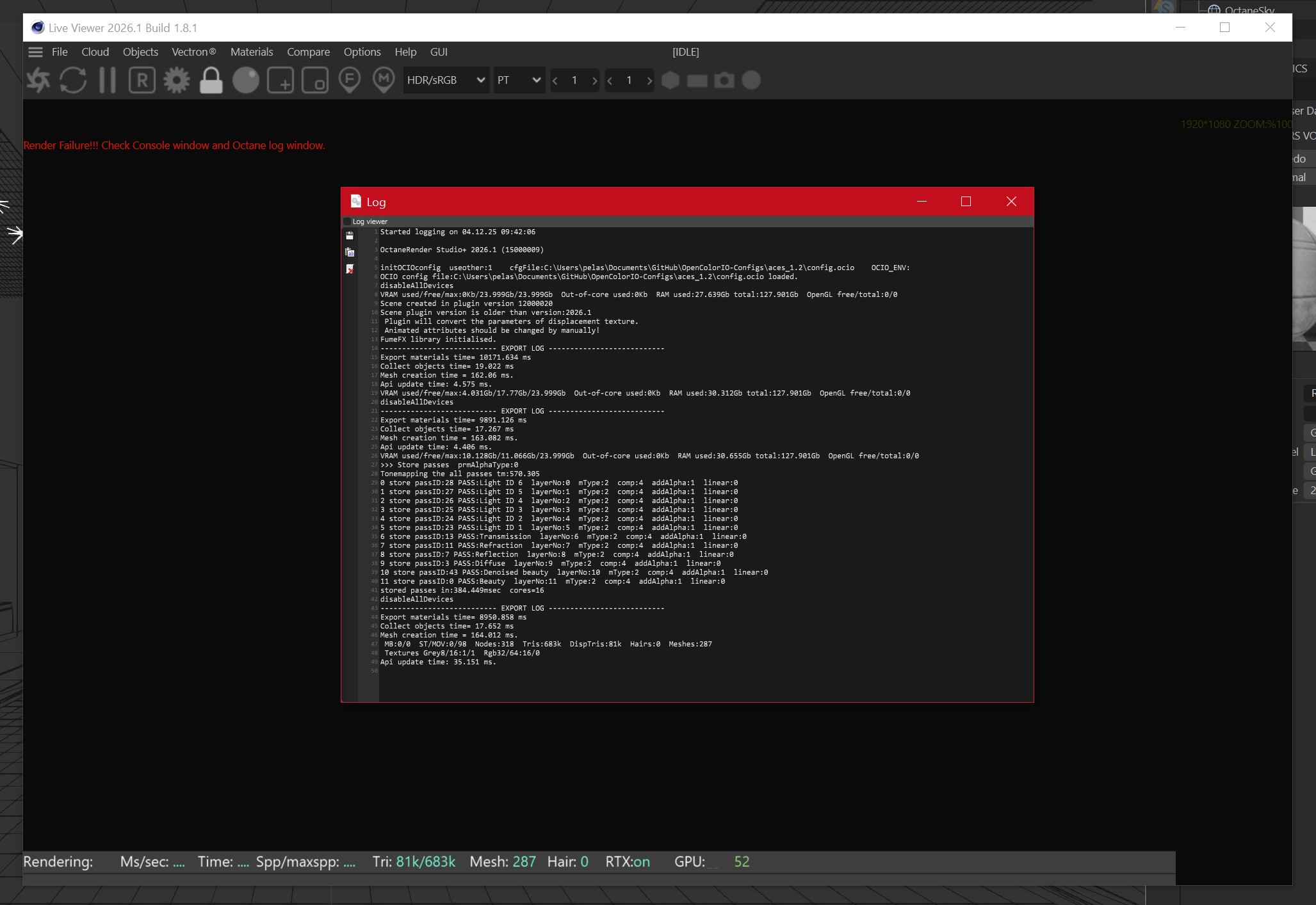

Well, was working great till I decided to open Render Kernel options window.
Than I got this crash.
Crash easy to replicate.

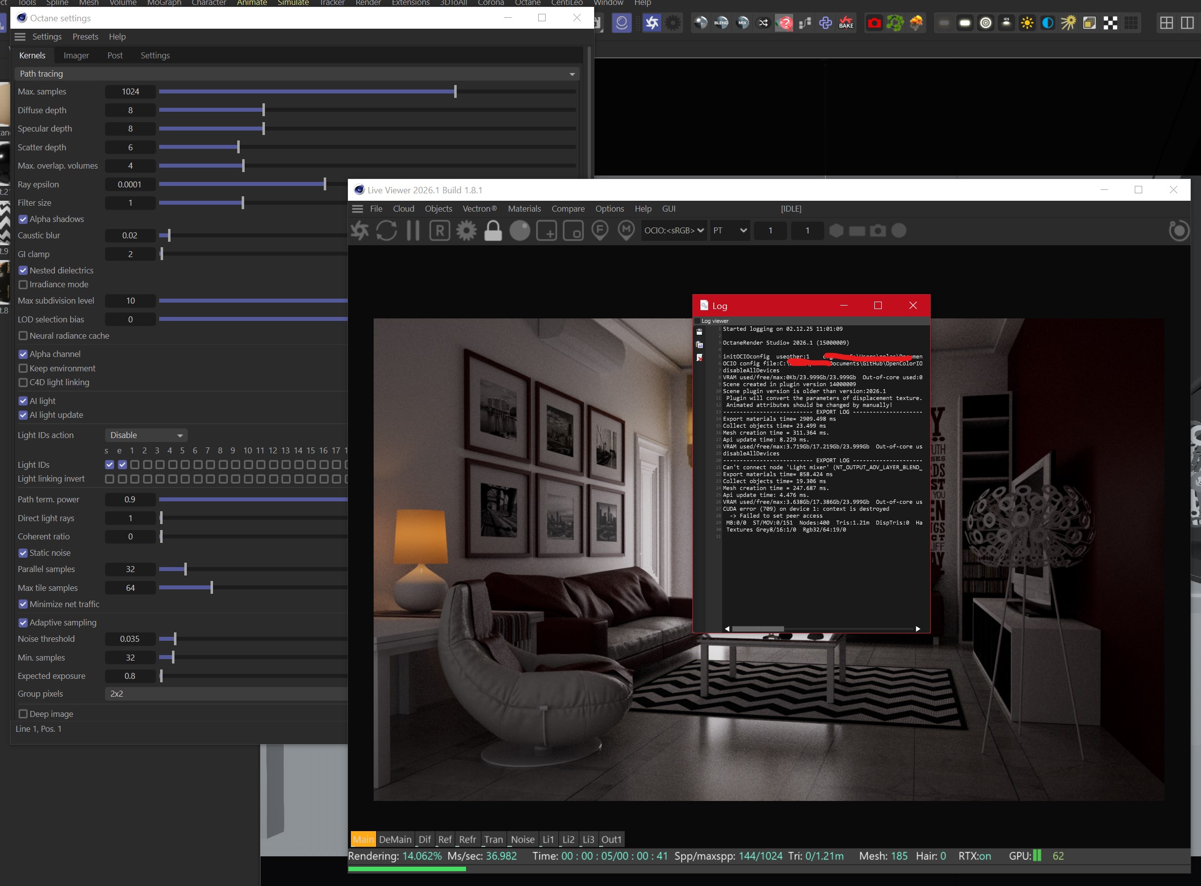

Has happened with 2 different scenes (made in older versions of Octane as u can read in the log). Though I have systematically used those scenes to test all new plugin versions and incrementally saved. First time I see a new Octane version give me such a severe crash with minimum interaction.
I open Liveview window, hit render, open the kernel window and the log report appears.
Will try with other scenes.
PS:Yep... 3rd scene with crash

Here, Team
Has happened in every single scene I have opened so far.
Hope it helps.

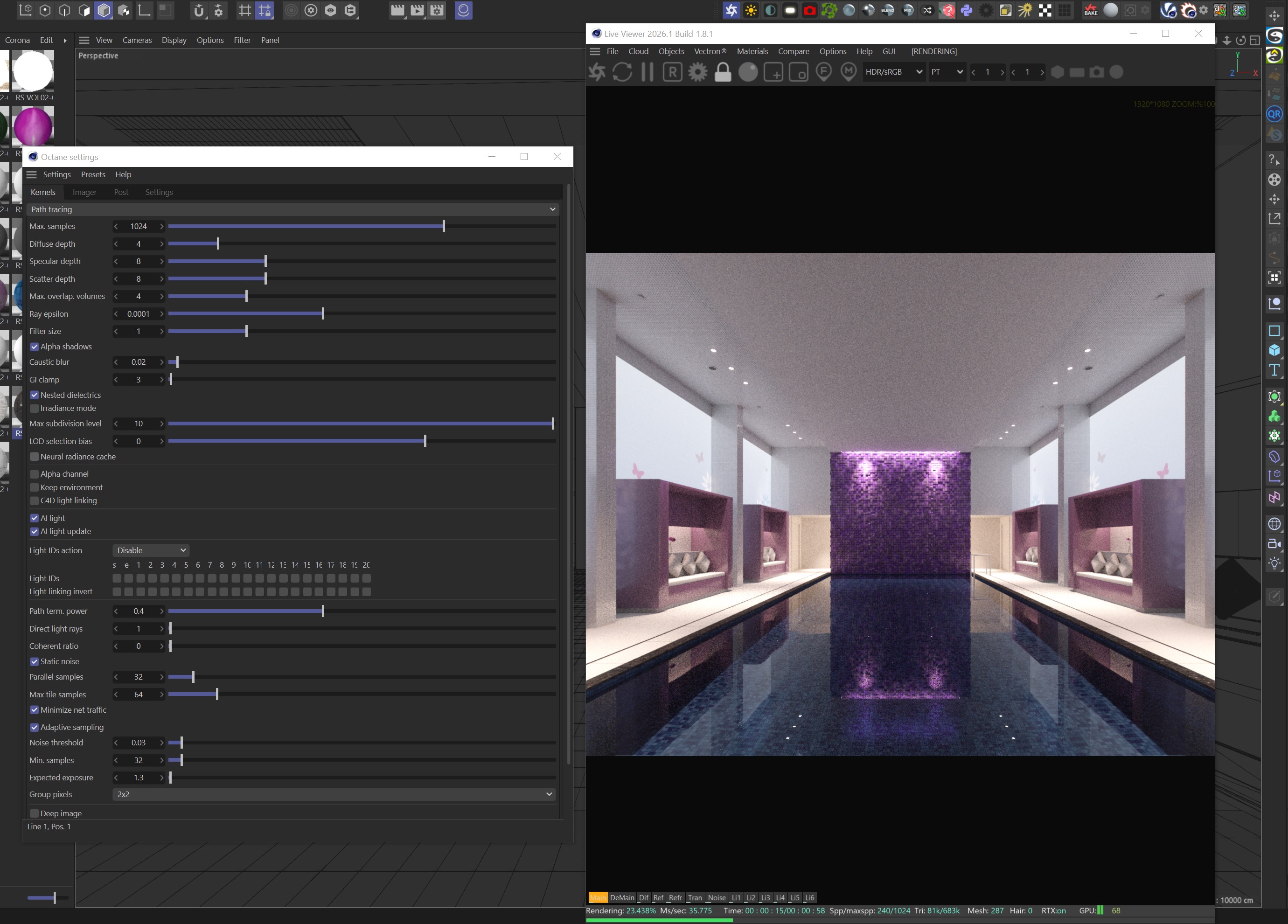

However, in this scene I particularly show now, If I open the Kernel settings window first, and hit render later, then error doesn't happen.
If I close live-view window and settings, and open again... hit render (without settings opened) I get the error again.
I saw this fail too though in other scenes.
Closing all windows and reopening Live-view and hitting render causes error.
Render Settings window opened before Live-view and rendering causes no error in this scene
