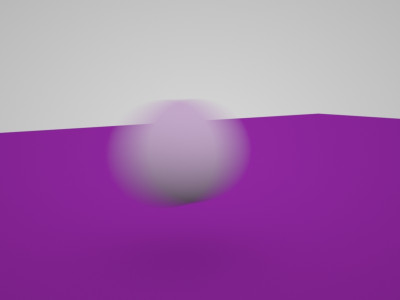

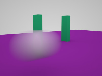

There is a bug with motion blur.
The camera is attached to the moving sphere, but the sphere is getting motion blur as if it were passing by a stationary camera.
The scene is attached.
It should be the opposite — the background should have motion blur because both the camera and the sphere are moving.
Can this be fixed ASAP?
