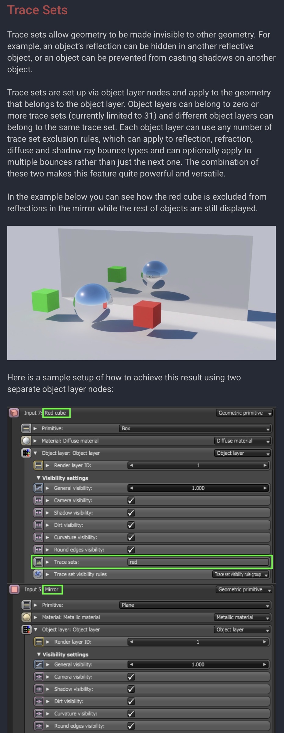

Have you tried with Standalone 2026.1-Alpha3 and new Trace Sets feature?
viewtopic.php?t=84831
In upcoming 2026.1 version, Trace Sets will be even more powerful.

This seems like it will solve all of the limitations I was having!
