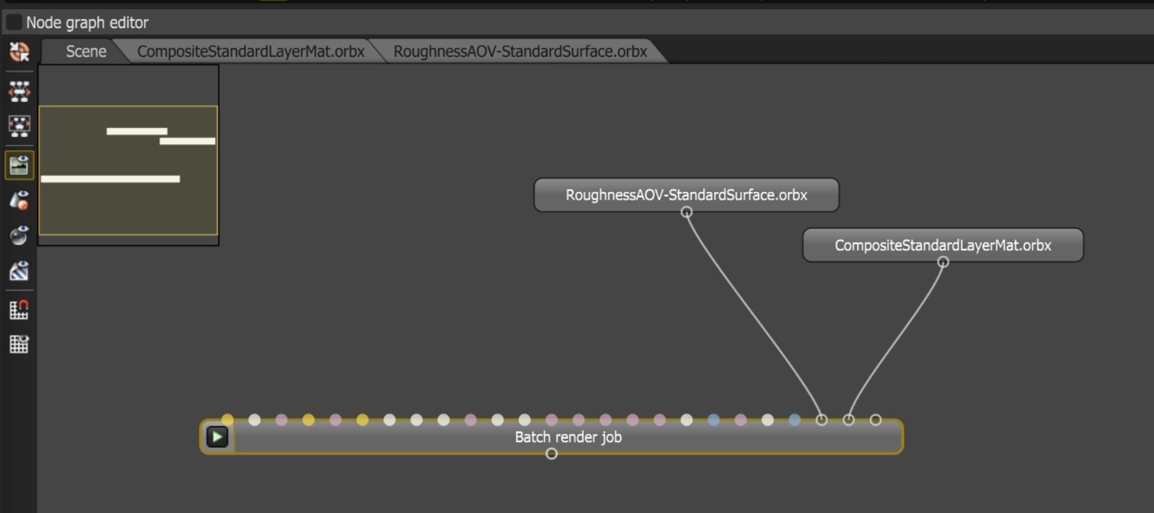

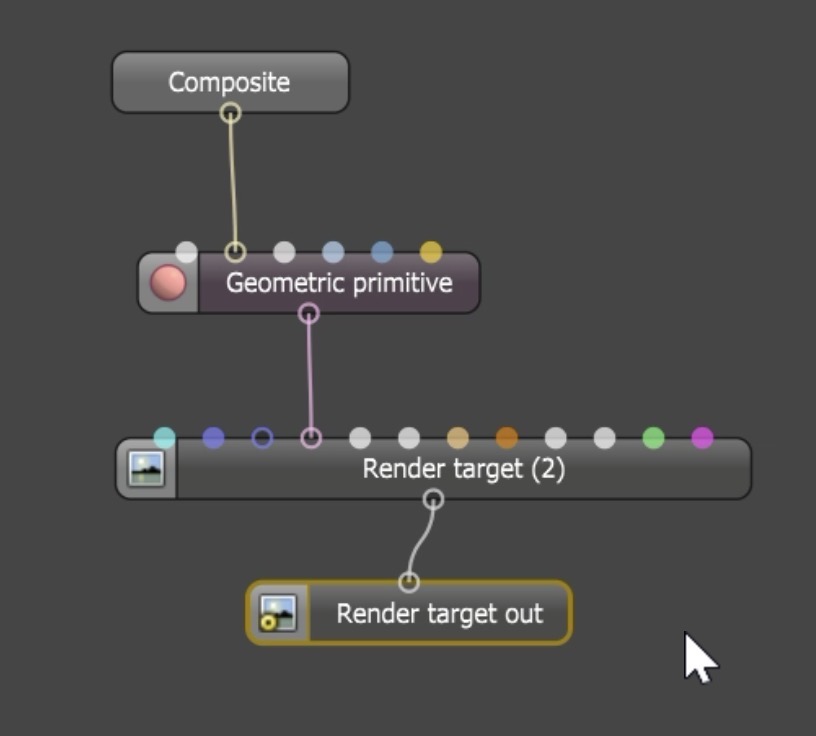

Not only with the same scene, you can import multiple .orbx scene into one .ocs scene (so they are not imported but only linked), then create an output render target node for each .orbx node graph:
Then connect them to a Render Job node:
Alternatively, have a look at the following lua script:
viewtopic.php?p=431684#p431684
