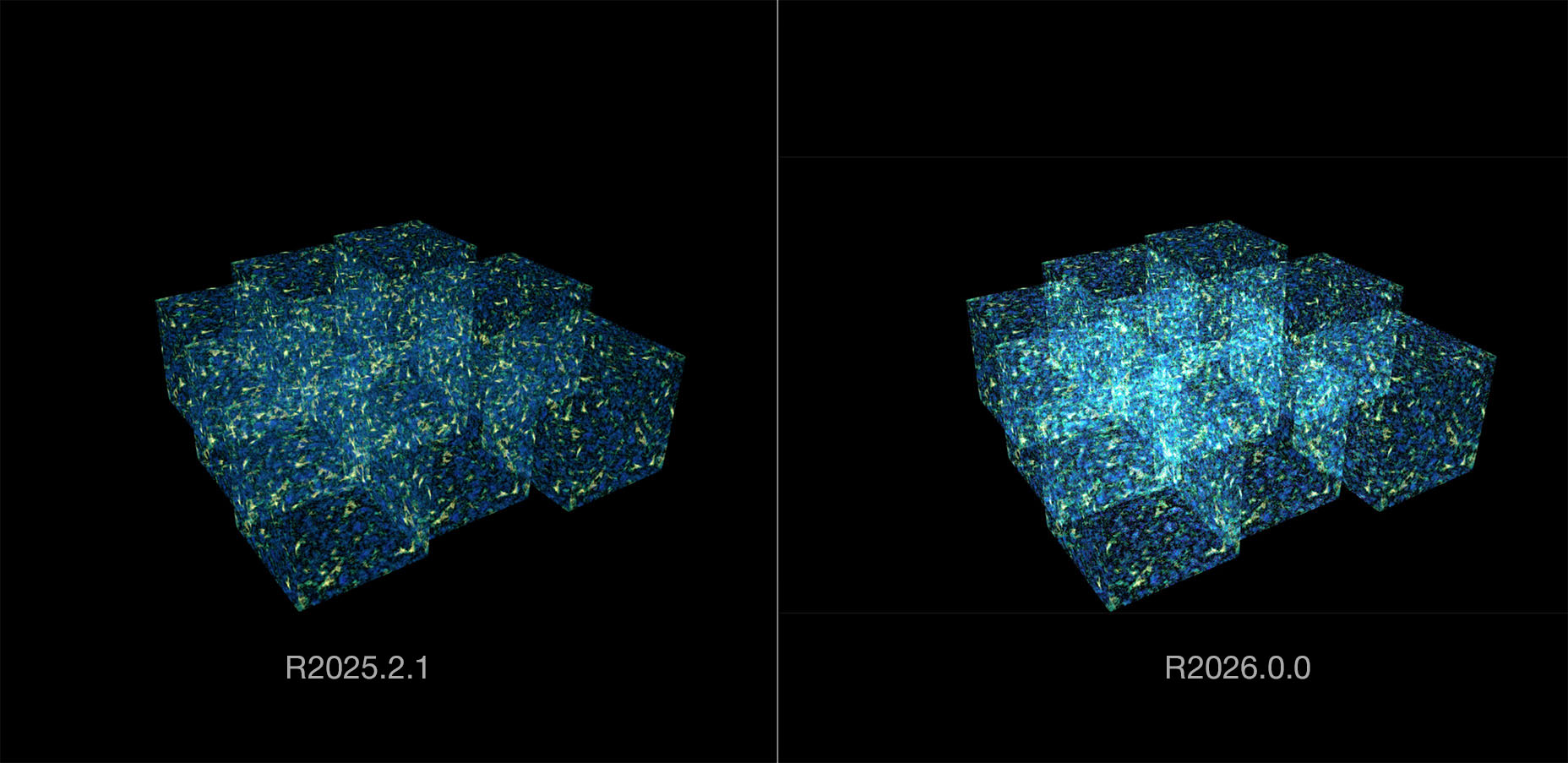

I noticed there are color (calculation) difference between Cinema4D 2025.2.1 & 2026.0.0.
My guess is this can probably be traced back to the new color management settings in C4D 2026, but as far as I can see they seem to be correct (legacy due to the file originating in 2025).
I'm not sure how to fix this, as every setting seems to be as intended. Any dev that can chip in?

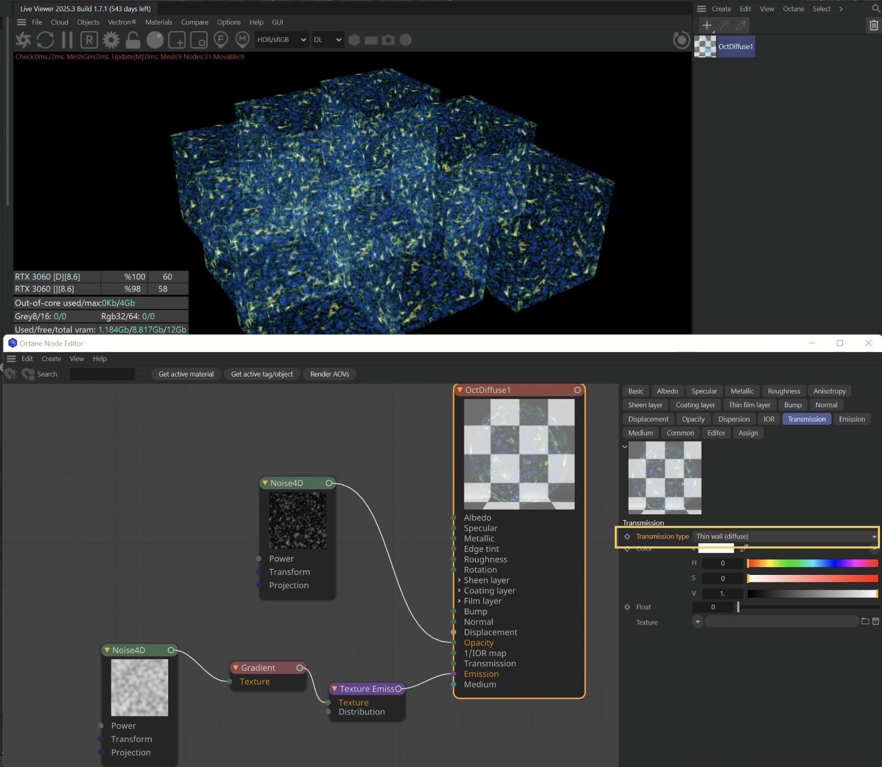

Posts: 10646
The issue is not in C4D 2025 or 2026, but in the Transmission type menu that is not working in plugin version 1.7.0.
To have the same result in new plugin version 1.7.1, you need to set the Transmission type to "Thin wall (diffuse)":
ciao,
Beppe

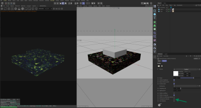

Tim_Twisted
Posts: 53
Joined: Mon Apr 23, 2018 1:31 pm
bepeg4d wrote: Mon Oct 06, 2025 8:50 am
Sorry, can you share the new scene?
The issue is not totally clear.
ciao,
Beppe
Sure, see attachment. Only difference is a cube with a default specular material. If you open this in Cinema 2026 the refraction inside the cube is way too bright, while 2025 looks normal.

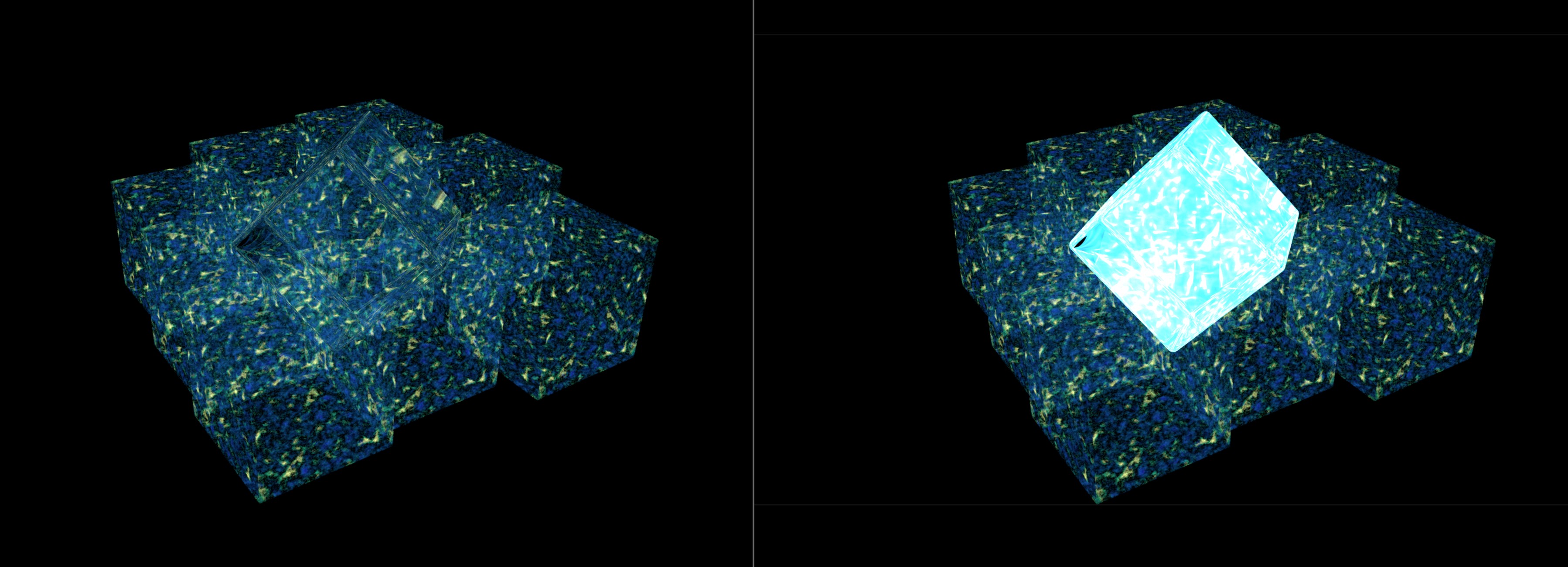

DinoMuhic
Posts: 226
Joined: Wed Mar 25, 2015 10:24 pm
Tim_Twisted wrote: Mon Oct 06, 2025 12:38 pm
ciao,
Beppe
I do not think this has to do with the c4d version, since it does not look correct for me in C4C 2025.3.1 either.
However when I go into the Emission node and turn "Transparent Emission" on and off again, the result looks correct.
When was this scene made and with what version of Octane? Trying to find the culprit now.
