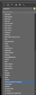

https://docs.otoy.com/3dsmax/ColorVertexAttribute.html
The attached screenshot refers to the Octane geometry properties panel.
Regards
Paride

Hi, thank you for your answer. Could you be a little bit more specific ? where am I supposed to put this Octane geometry properties modifier ? on the Tyflow system or on the original object? And what are the seetings ? I am sorry to ask all these questions but the documentation is not so clear for me. Thanks a lot for your precious help.
