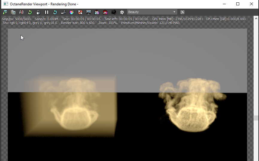

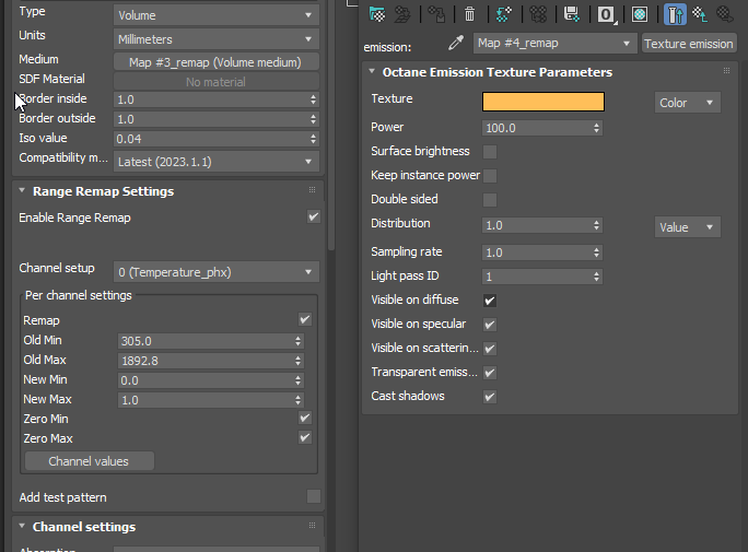

--- Sample :
Range_Remap\fire25_10_NoRemap_vs_remap_mx18.max
2 volumes objects, using the same VDB file.
Note that with no remap (OctaneVolume_001), Absorption scale is set to 0.001 and Emission scale to 0.002
This is to reduce the temperature channel values (range 300,2000)
The medium used (Map #3_NoRemap) has a Texture emission (Map #4_NoRemap) with Power set to 0.46
With remap (OctaneVolume_002), as the range options is set from [305,1892] to [0,1], Absorption and Emission scales are set to values around 0.5.
And the medium used (Map #3_remap) has a Texture emission (Map #4_remap) with Power set to 100
--- Sample:
Range_Remap\fire25_11_vdbs_vs_Phx_mx18.max
The PhoenixFD modifier has the same remap interface as the OctaneVolume.
The remap range for PhoenixFDFire001 is set the same as OctaneVolume_002.
Both use the same volume Medium.
Note that only Phoenix frame 21 (PhoenixFDFire001_0021.aur) is provided.

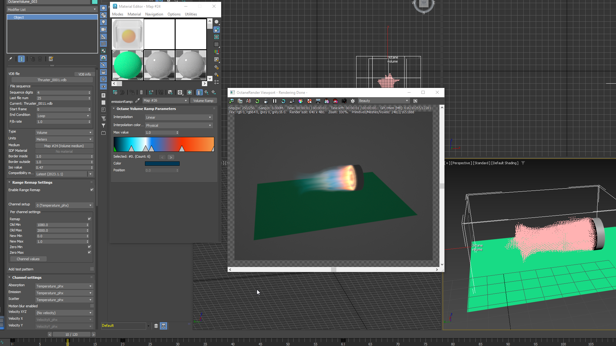

---Sample: Color gradient.
OctaneVolume_Thruster_ColorGradient.zip
(54.5 MiB) Downloaded 136 times
By remaping the range of a fire simulation, we can remove the surrounding turbulence, and keep the center of the fire to simulate an engine thruster.
Remaping to a [0,1] range makes it more easy to apply a color gradient:
Note that the Emission scale is animated to simulate an engine power variation.
thrusterAnimOut.flv
(302.44 KiB) Downloaded 94 times

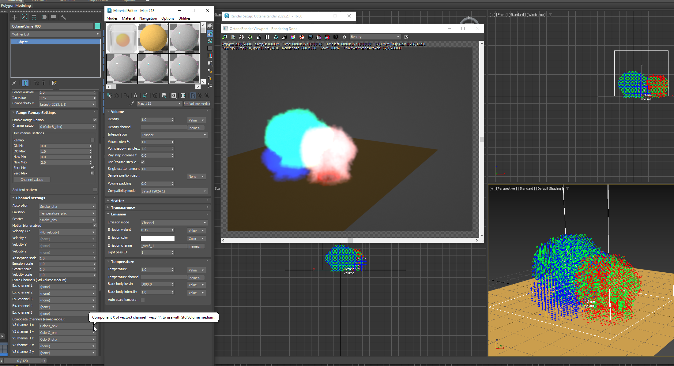

--------- Composite Channels -----------
The composite channels mode can combine 3 single float channels to a vector3 channels.
There are 2 vector3 channels that can be created this way, named '_vec3_1' and _vec3_2'
This is specially designed to be used with the 'Std Volume medium', that can select those vector3 channels for Emission, Scatter, etc..
The typical use case is for RGB color channels, when they are only available as separate R, G and B channels.
Another usual vector3 channel is the velocity, but the Octane Volume already has an option to select velocity as 3 separate channels (x,y,z), or a single vector3 channel, so there is no need to use this Composite mode for velocity.
To use the composite channels, make sure 'Enable Range Remap' is turned on in Range Remap Settings
Samples:
OctaneVolume_RGB_Channel.zip
(20.71 MiB) Downloaded 102 times
Volume_composite_RGB_emission_mx18.max
The VDB used has 3 channels for the color: one for each color components : ColorR_phx, ColorG_phx, ColorB_phx.
Those 3 channels are set in the 'V3 channel 1 (x,y,z)' parameters, so the combined vector3 channel is available as '_vec3_1' in the Map #13 medium (Std Volume medium).
Note:
Those VDB files have been created with Phoenix FD, with RGB channels.
(specifying .vdb in the output rollup: Simulation Cache Save Path: $(scene_path).vdb)
See the related post 'Phoenix FD Fire color channel' : viewtopic.php?t=83095
The resulting VDBs have the up axis as Y instead of Z, so the OctaneVolume object has been rotated to compensate.
(There may be some options in Phoenix FD to export with Z as the up axis..)
Volume_composite_RGB_scatter_mx18.max
In this case, the combined rgb channel '_vec3_1' is used as the 'Scatter color channel' of the Std Volume medium.

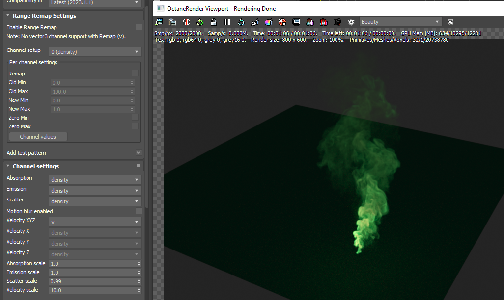

Hi remKa,
In fact, remap with velocity works fine: I might have forgot to enable camera motion blur !
Here are some samples:
Volume_MotionBlur_Remap.zip
(51.42 MiB) Downloaded 108 times
VdbVelo_3_floats_Remap_mx18.max
This sample is using Range Remap and velocity for motion blur.
In current version, the 3 velocity channels x,y,z need to be set in the Combine channels first 3 slots, to use velocity as a vector.
The '_vec3_1' channel should be available in the 'Velocity XYZ' selector.
(if it appears as '[n/a] _vec3_1', you may need to refresh the dialog by deselecting and re-selecting the volume object)
Make sure the camera motion blur is enabled, and adjust the Shutter time while rendering in Octane Viewport, to check the volume motion blur effect.
As the velocity values might not match the scene scale / import 'Units', you can start with a high value for Velocity scale (eg 100.0)
See the same volume without remap, VdbVelo_3_floats_noRemap_mx18.max:
The 3 velocity channels are set in the 3 velocity slots, and Velocity XYZ is set to '(Use ch. X, Y, Z)'
Note that some artifacts appear on the borders of the grid.
Those cells have the lowest temperature (300) but that is not zero, so it's affected by the velocity of those cells, that are also not zero.
Using the remap mode with 'Zero min' ensure that those cells are set to 0, and won't be affected by the velocity.
Known issues:
-VDB files with single velocity channel as a Vector3 can not be used with Range Remap.
Note that Phoenix FD creates VDBs with 3 separate channels, so that will work with remap.
-The 'Motion blur enable' is not used in Range Remap mode.
To disable motion blur, set the Velocity XYZ to '(no velocity)', or Velocity scale to 0
