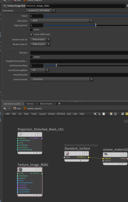

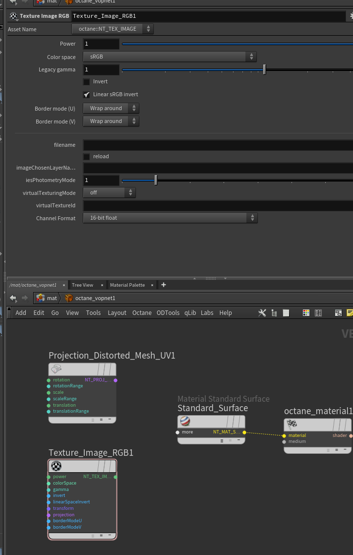

Output type for RGB Image is missing.
Distorted UVW projection node is missing.

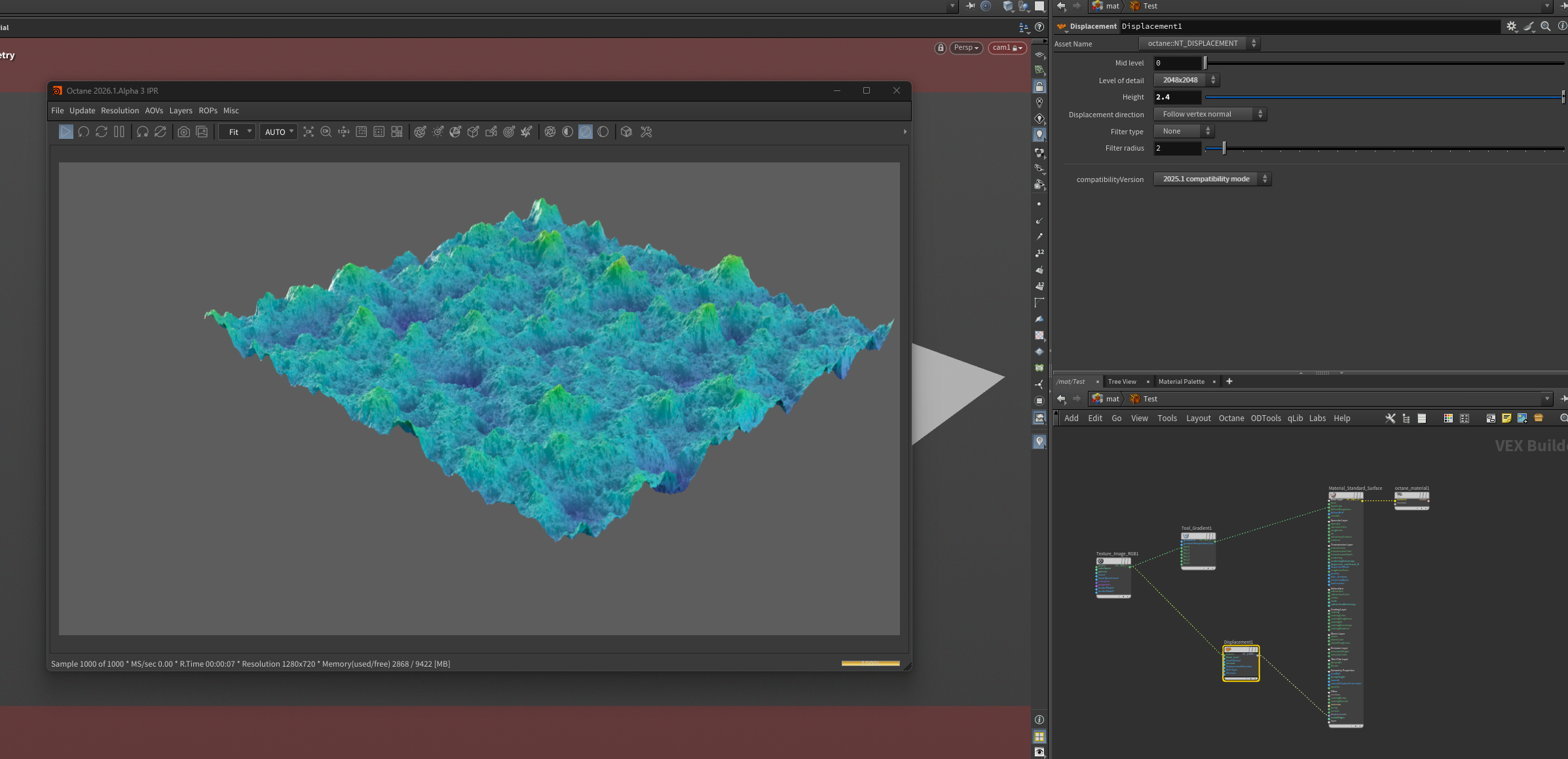

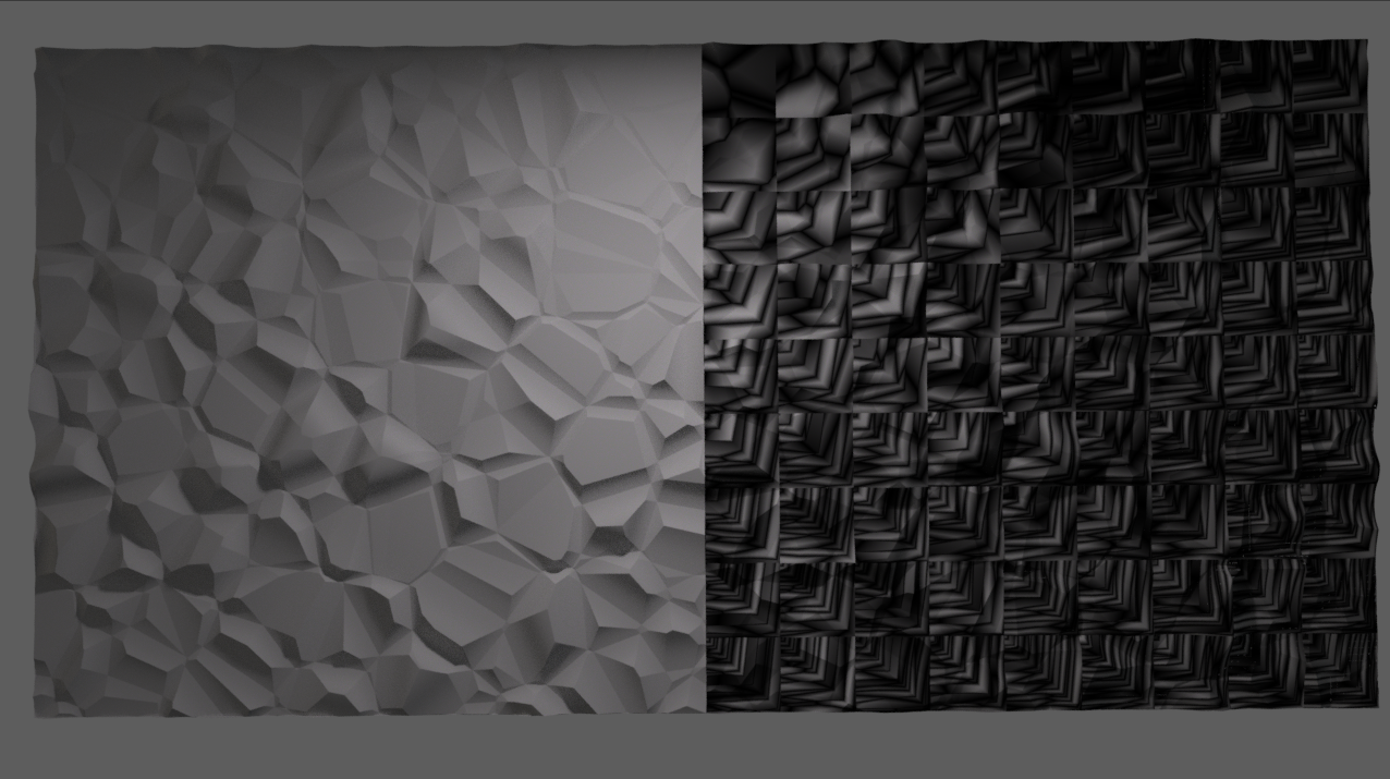

This is a core bug: Using displacement messes with the UVs so you cant use the same input for other maps(base color, rougness, etc.)
Left is with displacement only, right is with displacement and base color.
displacemenetbug.zip
(169.11 KiB) Downloaded 100 times
Win 10 64bit // GTX 4090 + GTX 3090 // 5900x // 64GB // SideFX Houdini // C4D

I think there are some combability issues there.
- if you put the displacement mode in 2025.1 combability mode - color works but displacement doesn't
- if you keep it in default 2026.1 mode - it's the other way around

galleon27 wrote: Wed Sep 10, 2025 9:59 am Output type for RGB Image is missing.
Hey there!
Sorry for the issues you're running into.
Do you mean the Distorted Mesh UV node? It's here for me. What H version are you using?
Also what do you mean with output type for RGB image? Is this not what you are seeing?
Happy Rendering!
Dom - Octane Houdini QA Engineer
:!: Btw did you know Octane has a discord? https://discord.gg/F4WENTG :!:
It's a great place to get very fast feedback or support from me and other Octane Houdini users.
I'd highly recommend it!

galleon27 wrote: Wed Sep 10, 2025 11:38 am This is a core bug: Using displacement messes with the UVs so you cant use the same input for other maps(base color, rougness, etc.)
Yes, there are quite a few bugs with the new octane displacement. It's best to use in compatibility mode for now. The next alpha release should have a lot of improvements on this.
Happy Rendering!

DamjanMX_1 wrote: Wed Sep 10, 2025 12:24 pm I think there are some combability issues there.
I've been using the displacement a lot and yes, the UVs are messed up when using the 2026 mode, but the compatibility mode has been working fine for me.
I'm not sure what you mean with color works but displacement doesn't? Do note that displacement only work with uv projection.
Do note that most of these issues with the displacement should hopefully be resolved in the next 2026 alpha release.
Happy Rendering!
