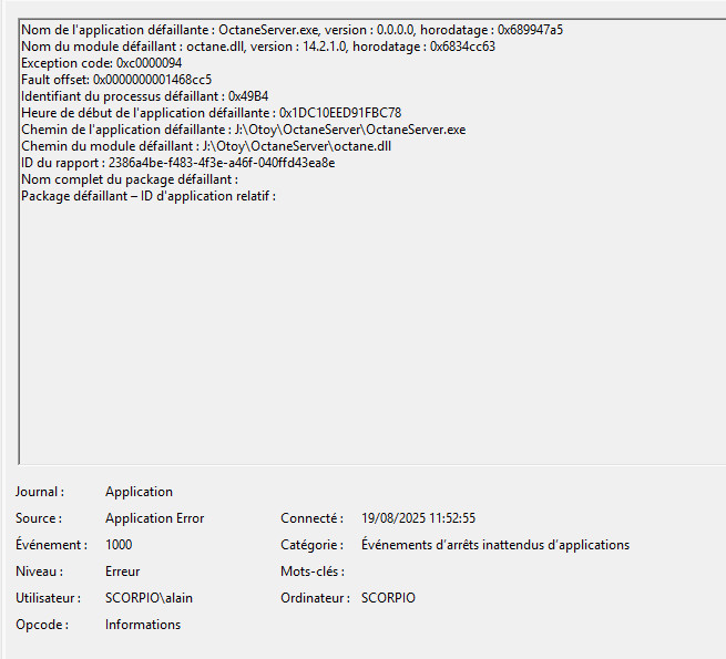

Small correction, I do have an error message in the Windows event viewer, always the same : (in French)
This appears when the Octane server crashes.
I've read that this OctaneServer.exe crash issue could be a driver issue.
I tested it with the latest 580.97 drivers (Game and Studio) and the older ones (576.88), and I got the same result: it crashes.
