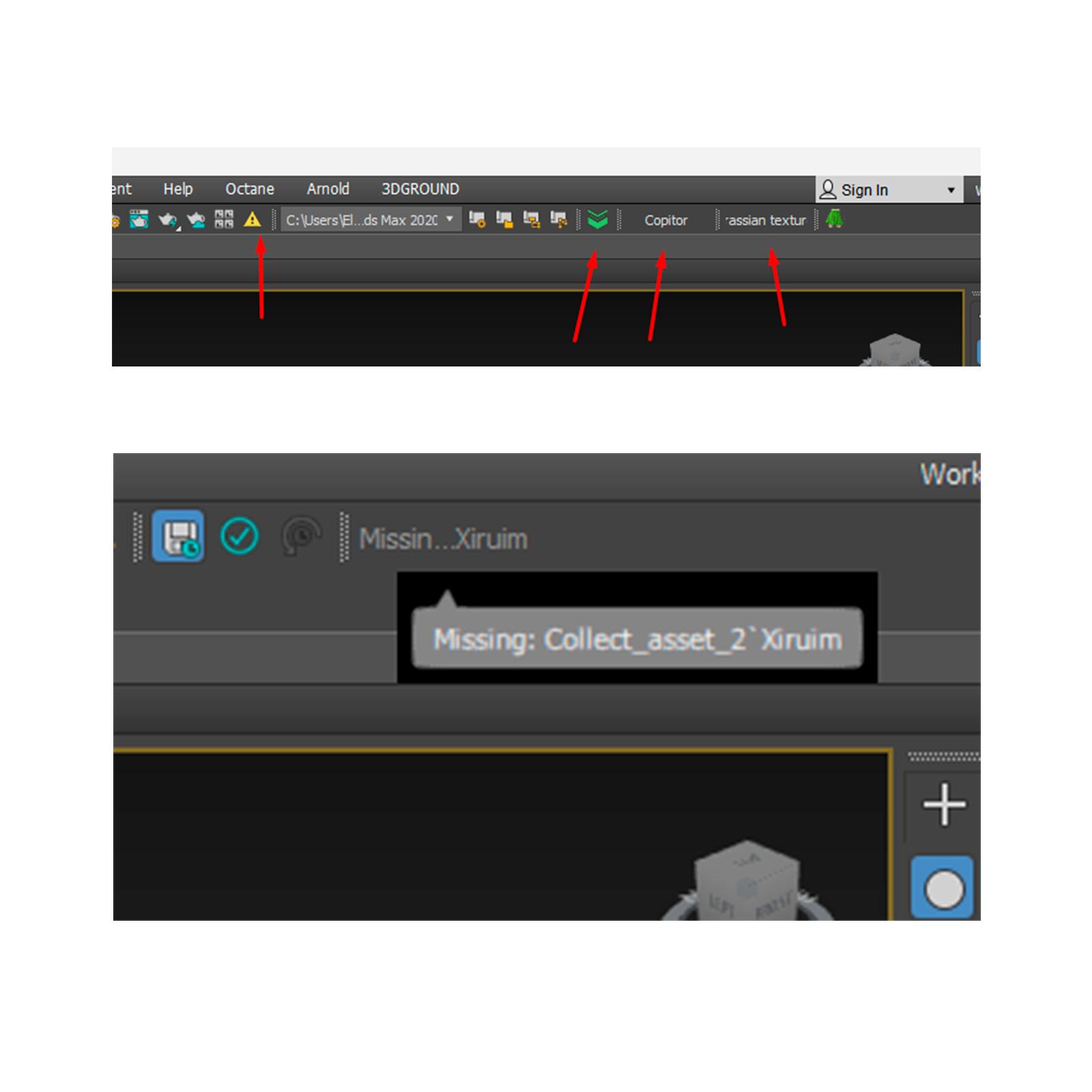

Thank Elvis,
it completely broke down my 3ds Max, I now have to run it as administrator, so I can only open scenes if I open a fresh Max, otherwise I get a shit ton of errors for missing files/plugins/dlls and what not. I also constantly have to re-do the UI because it resets to default.
Can you suggest a method to revert what you did?
Because I can't work like this I'm thinking of re-installing everything.
Cheers
