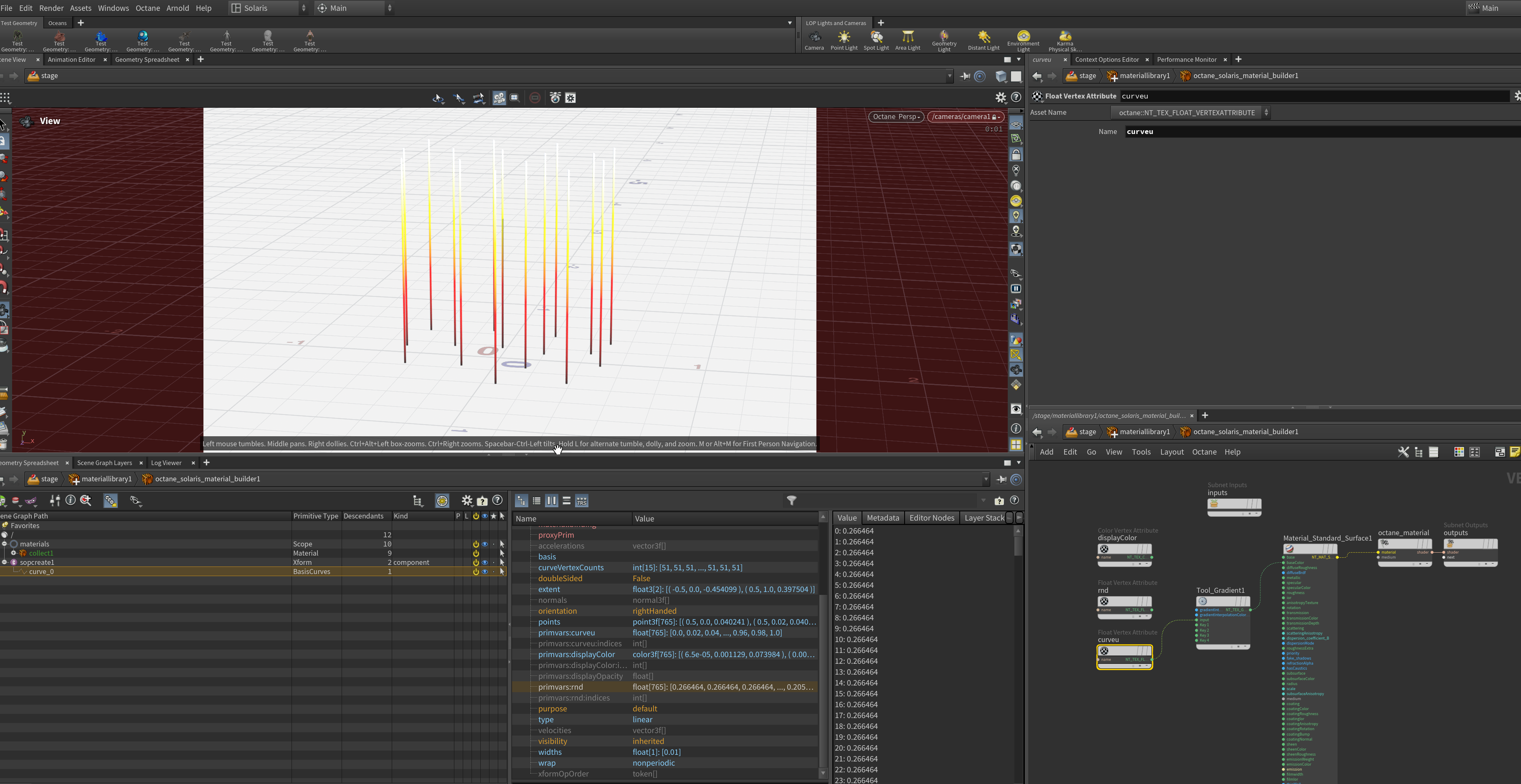

Thanks for the feedback, BK!
I have attached the file. In it, I'm trying to transfer the attributes ('rnd' and 'curveu') to base color. To do this, I use the Float_Vertex_Attribute node. Also in SOPCREATE, in the import data column, I enabled a checkbox before attributes. Maybe I'm doing something wrong, since I'm just learning solaris, but when I connect displayColor, everything works.
There is another problem. If you enable pack and instance in SOPCREATE in the copytopoints node and put the checkbox in the primitive definition near Create point instances and update the render, then houdini crashes.
I will be glad if you point out to me the mistakes that I make.

Hi ArtyomPapikyan,
Thank you so much for your patience.
The attributes `rndr` and `curveu` render fine with the OctaneRender for HoudiniSolaris 2025.2.1.1.
Please let us know if this what you are after.

Thanks for the answer, BK! I'm going to upgrade. ;)
