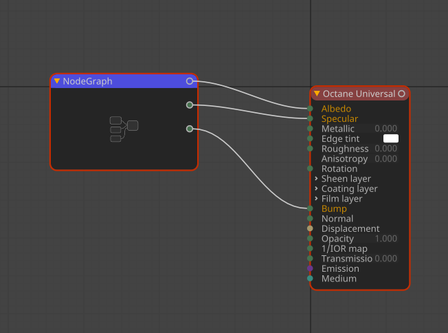

The outputs may need to be connected to something before grouping the nodes? Not sure if this is the only way, but when I group stuff (e.g. just some RGB spectrum nodes) that already flows into the material, then the output pins do show up on the "NodeGraph" node with the connection still in place.
However, if i sever one of these connections I then cannot restore it again (without ungrouping, then re-grouping). This seems to be a bug? The pick whip / lasso thingy shows up correctly when dragging out from the output pin, but doesn't allow me to connect to an input pin.
