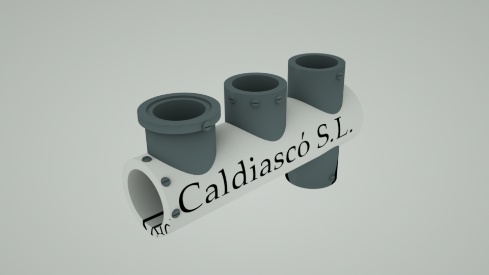

Hi Yoyoz, here's the file for you to check, I suggest you to open this file in both versions (2.49 and 2.56) and you will notice how different results in Octane Render just by clicking in the render button from the script, the script in 2.49 is working more close to the original render in Blender, while in 2.56 completly gets a different image, it has problems with UV's aswell as the exporting some of the materials, hope you can have a look, and I really apreciated you amazing work, thank you Yoyoz.

Hi Sam, I had to put a random image fortesting (you didn't put the source image in the zip), but with my WIP addon I have the same result in 2.49 viewport, 2.56 viewport and octane render after export from 2.56.
When rewriting the code I noticed that the texture export was not working as expected and it looks like I've already fixed that, without touching the UVs...
Unfortunately, a couple of issues prevent me from releasing this version at the moment. May be tonight or tomorrow...

Here's what I get straight out of the box, with coloroured clay rendering... I think you're going to push me for getting my latest script :-)
