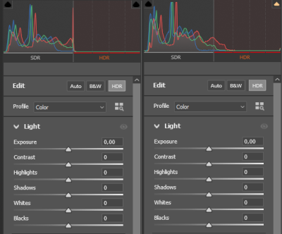

Hi Paul!
Yes, and no. The resulting file is 32 Bit, but it does not utilize the color space. In photoshop, it's clearly visible that it brightens to SDR white, then cuts off. When I export the same scene as ORBX, render in Standalone and export the render from there, the full space/HDR range is being utilized.
Here's what the curves look like:
I put together a collection of files with a bunch of stuff removed for you to take a look at. Maybe there will be some texture-linking issue in the .3dm knowing rhino, but it should work nonetheless. It looks weird since I played with the settings a bunch, but they are identical in the 3dm and ORBX.
HRD Issue.zip (Expires on July 31st)
I kind of hope I'm doing something wrong, but I don't know what to try anymore.
Thank you for looking into this!
EDIT: Imgur image embedding seems to not have worked, so I attached the comparison Image to the post
