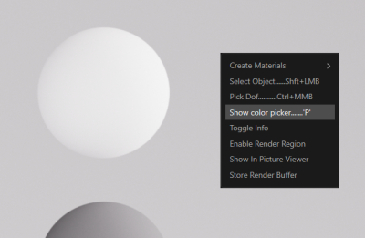

I'm unable to use the "Show Color Picker" function in the live viewer window. It's almost like it's there, I just can't see it. Any tips or things to try? Thanks!
Windows 11
5090 ASUS ROG Astral OC - NVidia Studio Driver 576.80
Cinema4D 2025.3.1
Octane 2025.2.1 - v1.6
