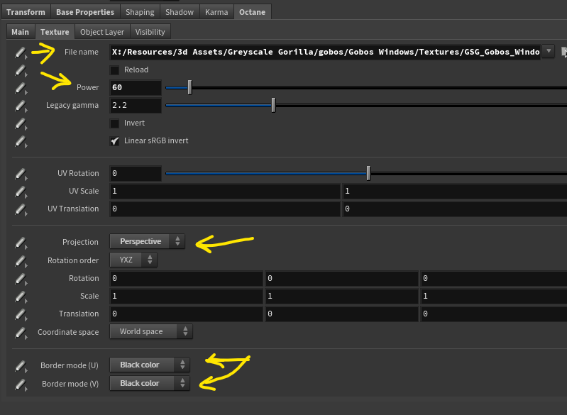

So the way to get gobos working in solaris octane:
1. Enable texture in octane main tab on the light
2. Load gobo into texture field
3. Set projection to Perspective
4. Set border modes to black color (unless you want the gobo repeating)
5. Set the lights uniform scale. If you want a sharp version of the gobo use a really small value. The bigger the light the "blurrier" the gobo.
6. To change the size of the gobo, change the UV scale.
Happy Rendering!
