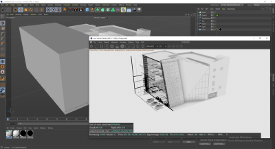

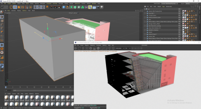

Here you can see some faces of objects are left behind (with no materials)

My geometry is exported from an external CAD software (Revit) and it causing issue specifically with the octane clipping material and not the native cineam4d boolean operation.
Is anyone able to explain why this happens and what the fix it? I know if i remove all the materials it helps (but leaves glitching faces). If I leave the materials, 1 face will always be visible.
If the objects have materials, then 1 face will be left behind when cut.

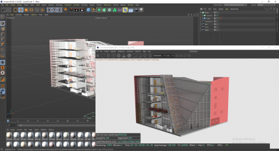

I've attatched the native C4D boolean image to show how it should ideally cut (it just doesn't have the thick solid intersection cut which I'd like) unfortunately. But this works with and without the mateirals.
Standard Boolean operation in C4D
