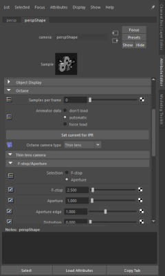

JimStar
Posts: 3812
Jozvex
I've just double-checked, and I can't reproduce this. The 24.7 plugin works without problems on my Maya 2026 installation. No errors generated for cameras, and the Octane rollout in camera's AE shows correctly and generates no error messages...
It's maybe something wrong with your Maya or plugin installations, or with Maya user-preferences maybe corrupted, or the scene itself, etc... Maybe reset Maya's user-preferences could help...
