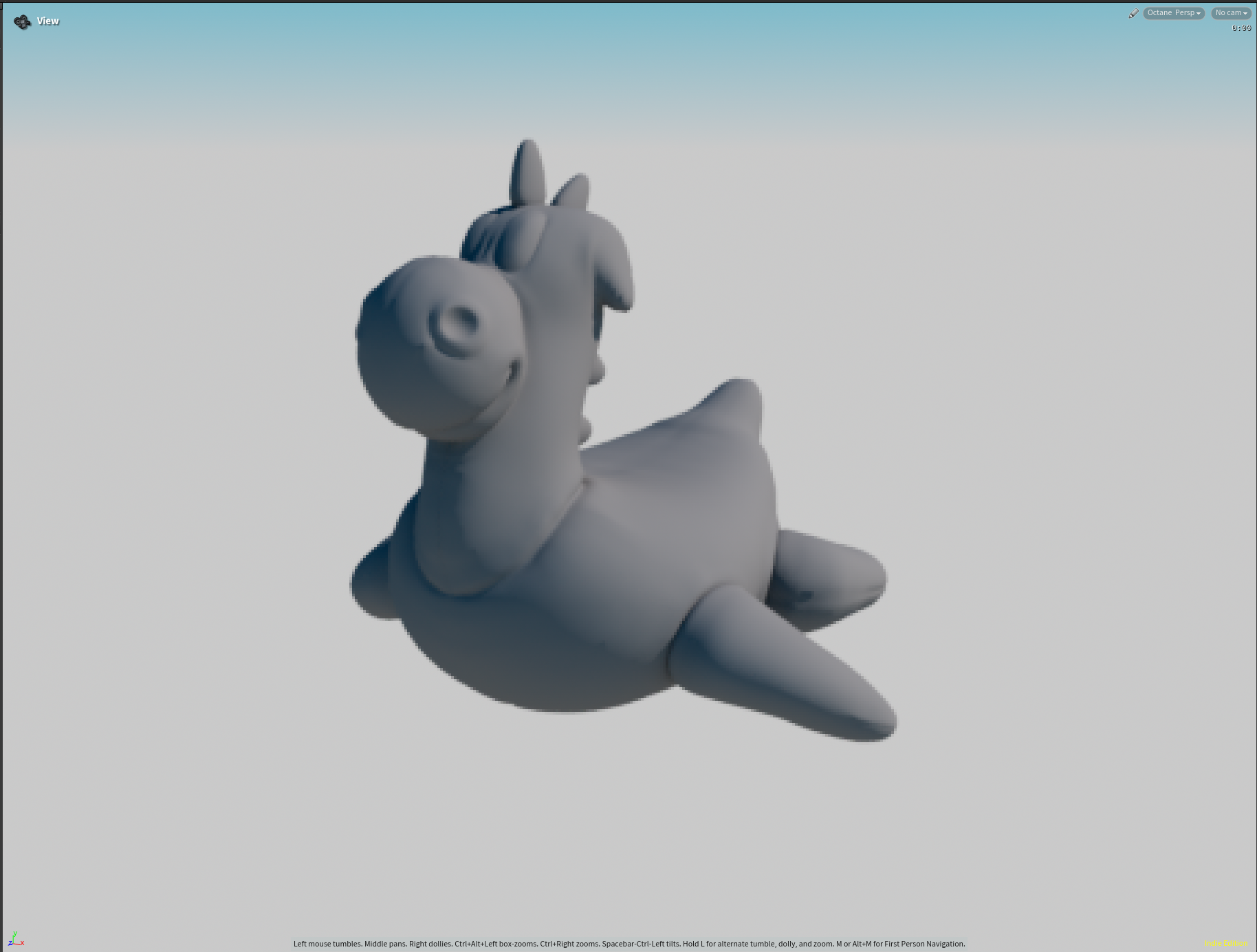

Object don't render when there is just a dome light lighting the scene.
2025-06-04 01-48-58.mp4
(15.11 MiB) Downloaded 129 times

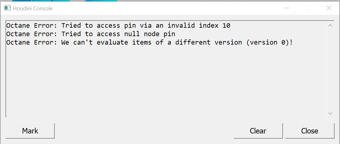

galleon27 wrote: Tue Jun 03, 2025 11:51 pm Object don't render when there is just a dome light lighting the scene.
I wanna expand on this. This only happens when there is only one primitive rendering. To replicate it just create a rubbertoy and a dome light and render. Nothing renders. Copy the rubbertoy and merge it. It should render now.
I also keep getting this error:
I've attached a test scene for this. Just disable and enable the USD asset to replicate the error.
solaris.zip
(618.38 KiB) Downloaded 87 times
