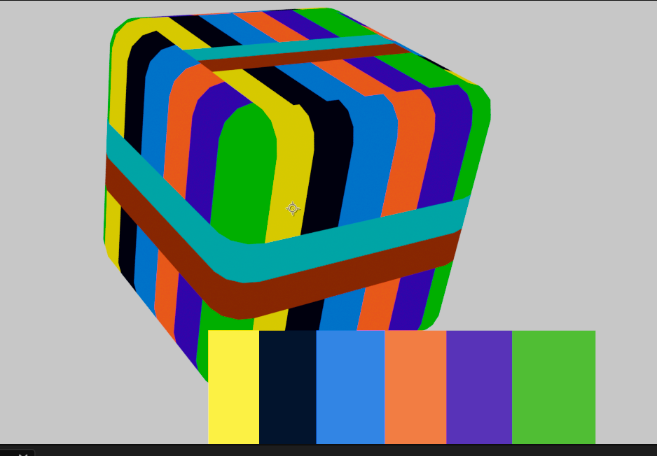

Hello,
I've been have problems exporting an Diffuse colour pass to match the colour texture map plugged into the diffuse material channel.
I'm using the default Aces tick pox and exporting Aces CG
I'm compositing in Ae and have the Aces work flow set up.
When I bring the texture map in I make sure this is interpreted as sRGB to view correct. However the Diffuse info channel for the render doesn't match Image
What's the best way to work with Aces and export a Diffuse pass that matches a defuse colour map?

Hi Ryan,
Could you please confirm exactly which pass you're exporting? For example, "Diffuse", "Diffuse filter (beauty)" or "Diffuse filter (info)". I assume it's Diffuse filter (info) because you mentioned info but I just want to make sure.
It would also be helpful if you could also attach the exact image file you're using for the texture, and ideally, also the test scene from your screenshot, exported as ORBX.
