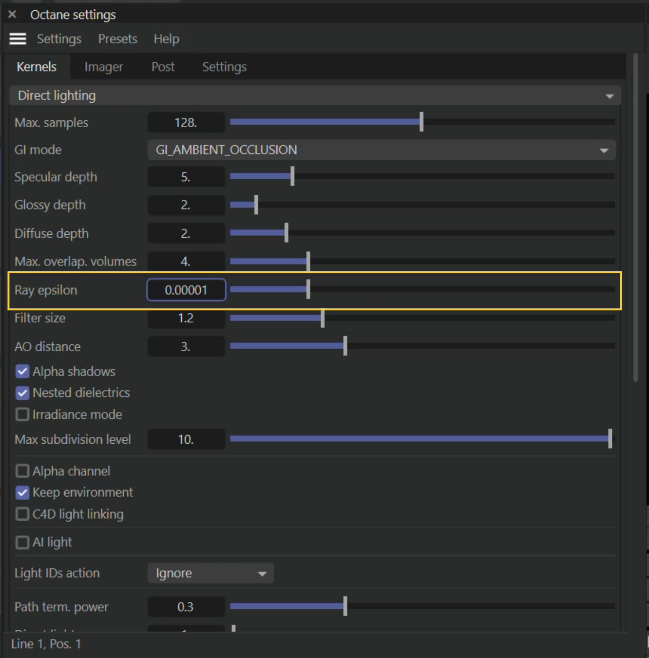

try to add a zero to Ray Epsilon value in kernel panel to reduce it and increase the precision of the rays:

Hello and thank you for your tip how to solve this issue... I figgured out this by scaling the scene up a bit, as 10 times and it also fixed the problem.
