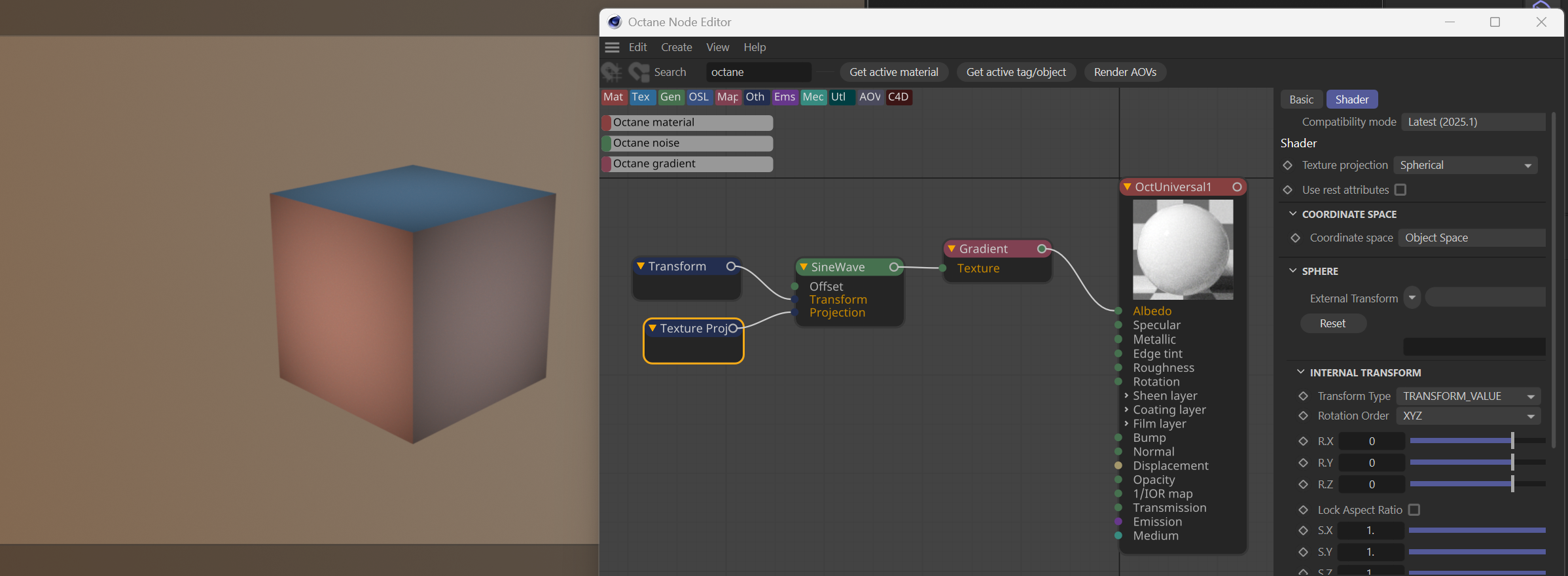

A simple universal material with an octane gradient set to radial crashes octane every time.
6850k // 32 GB // 1080, 1080 Ti, 2080 Ti // Win 10 // C4D 19.068

KeeWe wrote: Tue May 20, 2025 2:20 pm A simple universal material with an octane gradient set to radial crashes octane every time.
like this?
Works here, could you send us details about your machine and a test scene?

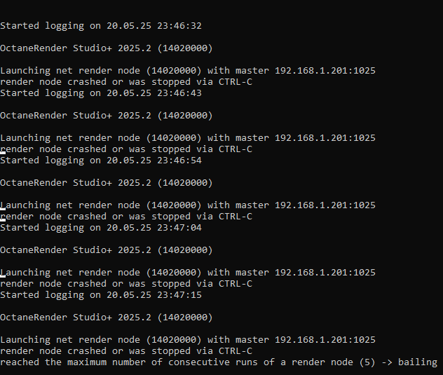

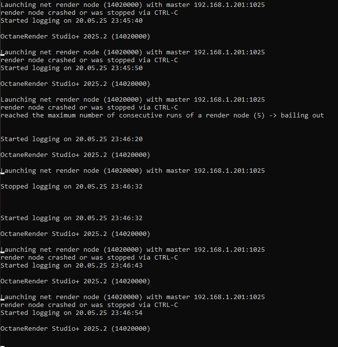

This version is causing 2 of my render nodes to fail continously, no matter what project I load.
All nodes have the same Nvidia drivers:
Screenshot 2025-05-20 235454.jpg (7.47 KiB) Viewed 1917 times
