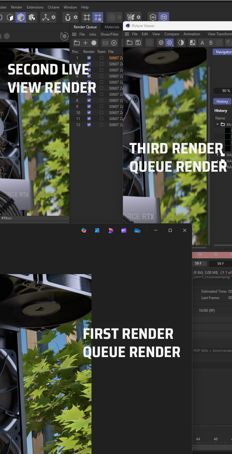

Actually its worse, it does this with a freshly made project in octane 2025.1 from scratch with no older octane 2024 cameras.
This project should blur the trees with DOF. I load it in, queue it up and hit render in the render queue. No DOF at all. I then render to live view, the DOF works.... I render from the render queue again after making no changes at all. The DOF now works.
