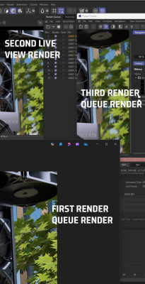

Video and project attached
Open the project
Render to picture viewer. The render has incorrect texture mapping
Render to live view. The render is now correct
Render to picture viewer. the render is now correct.
Only after rendering this project to the live view, will any final renders work properly.

Actually its worse, it does this with a freshly made project in octane 2025.1 from scratch with no older octane 2024 cameras.
This project should blur the trees with DOF. I load it in, queue it up and hit render in the render queue. No DOF at all. I then render to live view, the DOF works.... I render from the render queue again after making no changes at all. The DOF now works.

boxfx wrote: Thu May 08, 2025 3:27 pm Video and project attached
Open the project
octan 2025.1.0 0104
c4d 2025.2.1
win 11
geforce 4090
This seems fixed in the latest v1.5 plugin build.
Does the issue with teh DoF also happen for you in the latest v1.5 build? Do you have a scene file for this?

Problem seems fixed in 2025.2, will update if it happens again
